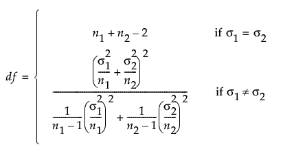

Statistical Details for the Confidence Interval for Two Independent Sample Means Explorer
The interval calculations for capturing the difference in population means is based on the standard normal or t distributions based on whether σ1 and σ2 are known or unknown.
The margin of error (MOE) is calculated as follows:
Equation shown here
When σ1 and σ2 are unknown, the MOE is calculated as follows:
Equation shown here
where
Equation shown here
When σ is known, the MOE is calculated as follows:
Equation shown here
where:
α is the significance level
z1-α is the (1 - α)th quantile of the normal distribution
t1-α,ν is the (1 - α)th quantile of the central t-distribution with ν degrees of freedom
n1 and n2 are the group sample sizes
σ1 and σ2 are the assumed group standard deviations.
