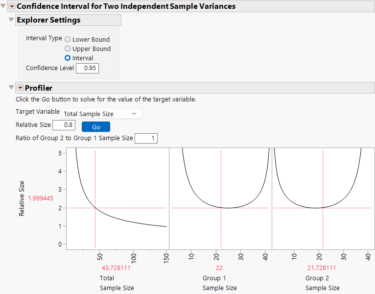

Example for the Confidence Interval for Two Independent Sample Variances Explorer
In this example, use the Confidence Interval for Two Independent Variances Explorer to calculate the sample size that is needed to estimate the ratio of two group variances with a relative size of 2 with 95% confidence. The calculated sample size enables you to estimate a confidence interval for the ratio of the variances that is twice as wide as the ratio of the variances.
1. Select DOE > Sample Size Explorers > Confidence Intervals > Confidence Interval for Two Independent Sample Variances.
2. Leave Interval Type set to Interval for estimating a sample size for a two-sided confidence interval.
3. Leave Confidence Level set to 0.95.
4. Leave Target Variable set to Total Sample Size.
5. Set Relative Size to 2.
6. Leave Ratio of Group 1 to Group 2 Smaple Size to 1 for equal group sizes.
7. Click Go.
Figure 29.10 Two Independent Sample Variance Explorer
You need to collect 22 samples in each group to estimate a two-sided confidence interval for the ratio of the sample variances of width twice the ratio of the variances.
