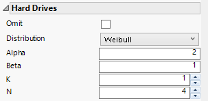

• For Series and Parallel components, you must also enter a value for N, the total number of components contained in the series or parallel shape.
• For K out of N components, you must also enter K, the minimum number of components that must function for the system to function, and N, the total number of components in the shape.

Figure 13.14 Example of a Weibull Configuration for a K out of N Shape
