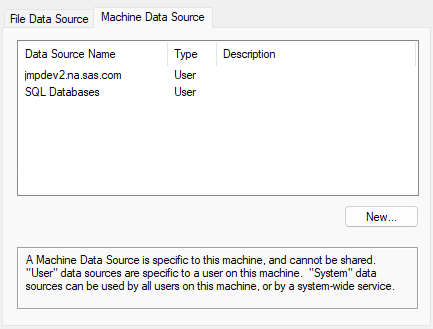

3. (Windows) In the Select Data Source window (Figure 3.54), click the Machine Data Source tab, select the data source, click OK, enter the user name and password, and then click OK.
(Apple macOS) In the Choose DSN window, select the data source, enter the user name and password, and then click Choose DSN.
Figure 3.54 Select a Data Source (Windows)

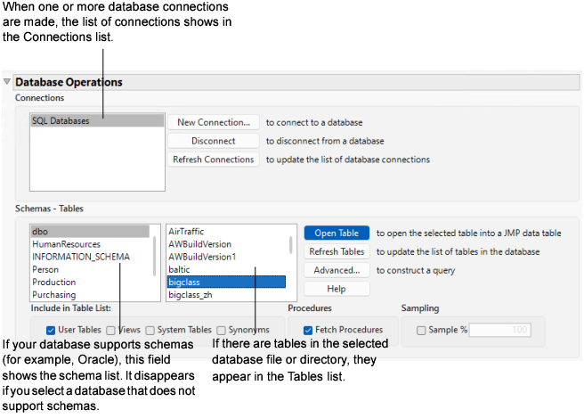

1. Select File > Connect To > ODBC > Open Database Table.
The Database Open Table window appears (Figure 3.55).
2. If you are already connected to the database, select it in the Connections box.
Follow the steps in Connect to a Database With Open Table.
The Connections box lists data sources to which JMP is connected. The Schemas - Tables box lists schemas for the databases that support them.
Figure 3.55 Database Open Table Window

4. Select the wanted data source in the Connections box.
The tables list in the Tables box updates accordingly. The update might take several seconds, depending on the number of tables and the speed of the connection to the database. If your database supports schemas, tables are loaded for the first schema in the list. Tables for other schemas are loaded as you click them.
5. Control which tables are listed by choosing the options in the Include in Table List group of check boxes.
Note: Different drivers interpret these labels differently.
User Tables When clicked, displays all available user tables in the Tables list. User tables are specific to which user is logged on to the computer.
Views When clicked, displays views in the Tables list along with all other file types that can be opened. Views are virtual tables that are query result sets that are updated each time you open them. They are used to extract and combine information from one or more tables.
System Tables When clicked, displays all available system tables in the Tables list. System tables are tables that can be used by all users or by a system-wide service.
Synonyms When clicked, displays all available ORACLE synonyms in the Tables list.
Sampling Enter the percentage of rows that you want to appear in the list of tables. Selecting this option speeds up queries in large databases. JMP uses the sampling method that is supported by the database. The check box is not available when the database does not support sampling.

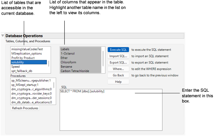

3. From the Database Open Table window, click the Advanced button to open specific subsets of a table.
4. Either enter a valid SQL statement or modify the default statement.
Figure 3.56 shows a default SQL SELECT statement that is appropriate for the selected file. For a description of SQL statements that you can use, see Structured Query Language (SQL): A Reference.
Instead, you can add expressions by clicking the Where button and using the WHERE Clause editor to create expressions. See Use the WHERE Clause Editor.
Figure 3.56 Reading All Variables from the Solubility Table Stored in an Excel File
5. Click Execute SQL.
