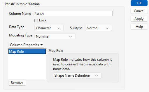

To add the Map Role property into the -Name data table
1. Right-click the column that contains the boundaries and select Column Properties > Map Role.
2. Select Shape Name Definition below Map Role.
3. Click OK.
4. Save the data table.
Figure 12.10 Shape Name Definition Example

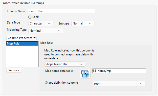

To add the Map Role property into the data table that you are analyzing
Note: Perform these steps only if your custom boundary files do not reside in the default custom maps directory.
2. Select Shape Name Use below Map Role.
3. Next to Map name data table, click Image shown here to navigate to a -Name map data table.
You can enter the relative or absolute path.
If the map data table is in the same folder, enter the file name only. Quotation marks are not required when the path contains spaces.
4. From the Shape definition column list, select the column in the map data table whose values match those in the selected column.
Figure 12.11 shows an example of the room/office column in the S4 Temps.jmp sample data table.
Figure 12.11 Shape Definition Column Example
5. Click OK.
6. Save the data table.
When you generate a graph in Graph Builder and assign the modified column to the Map Shape zone, your boundaries appear on the graph.

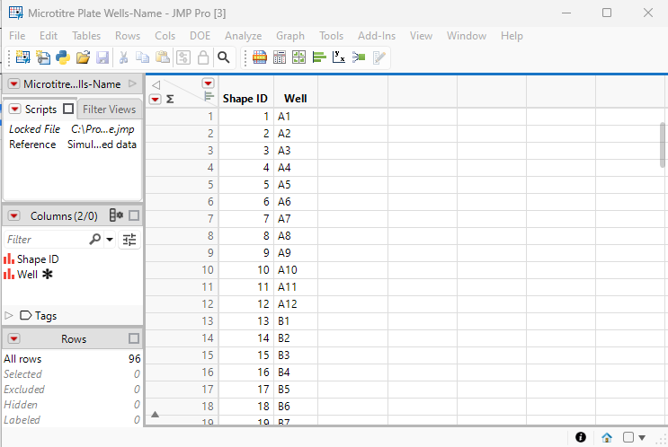

In the example, the Microtitre Plate Wells-Name.jmp shape file defines the link between the shape names (Well in this case) and the Shape ID.
Figure 12.12 Microtitre Plate Wells-Name Shape File

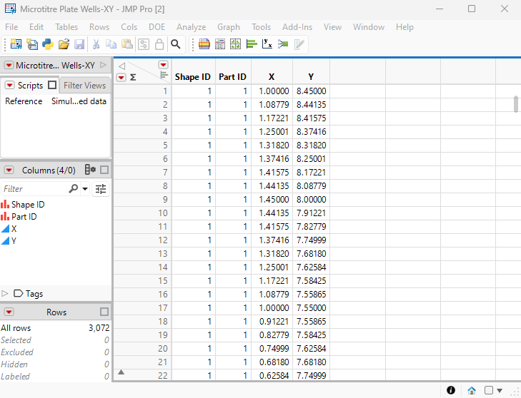

The Microtitre Plate Wells-XY.jmp shape file defines the Shape ID as a series of Part ID and the coordinates of the vertices of a polygon that are used to draw each part.
Figure 12.13 Microtitre Plate Wells-XY Shape File

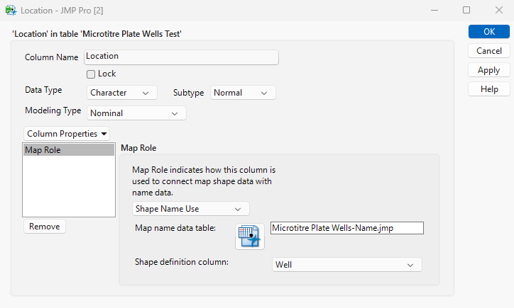

1. Select Help > Sample Data Folder and open Microtitre Plate Wells Test.jmp.
2. Right-click the Location column and select Column Properties > Map Role to see that the Microtitre Plate Wells-Name.jmp shape file is assigned as the map name data table under the Map Role.
Figure 12.14 Map Role Column Property Assignment
3. Click Cancel.

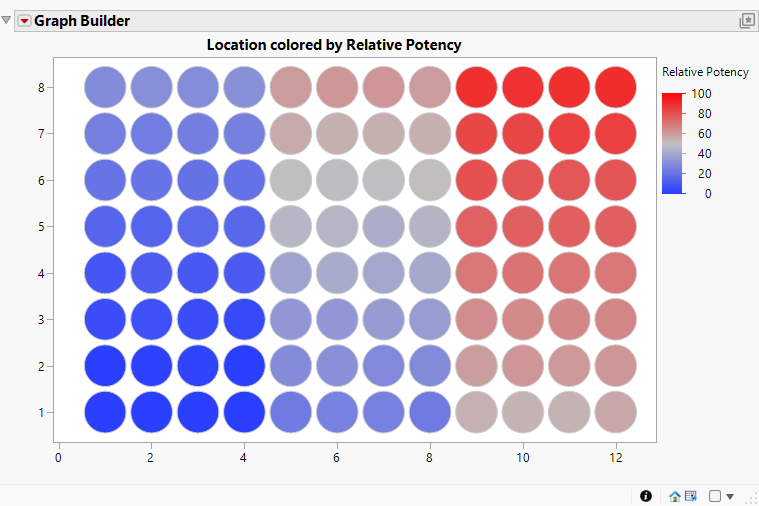

4. In the Table panel, click the green triangle next to the Graph Builder script.
Figure 12.15 shows the location of the well on the microtitre plate as well as the relative potency in each well.
Figure 12.15 Example of Microtitre Plate Well with Spatial Data
