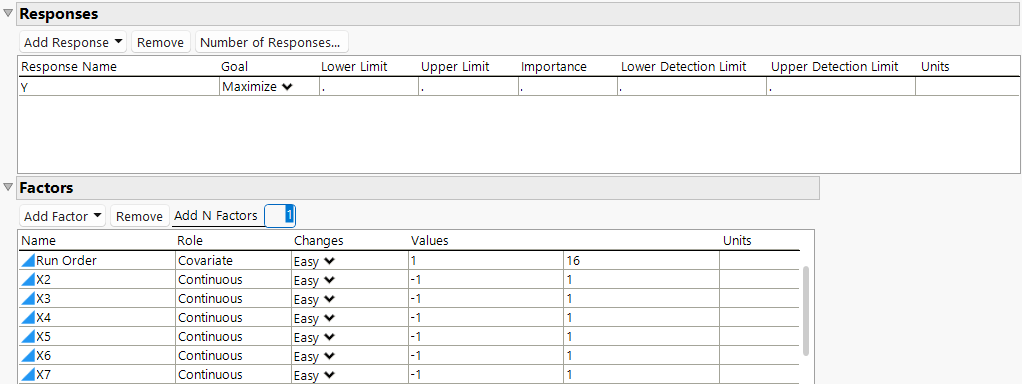

7. Select DOE > Custom Design.
8. Click Add Factor > Covariate.
9. Select Run Order and click OK.
10. Type 7 next to Add N Factors.
11. Click Add Factor > Continuous.
Figure 5.64 Responses and Factors
12. Click Continue.

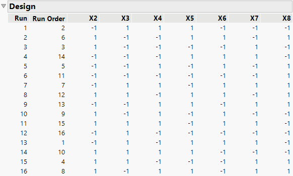

17. Click Make Design.
Figure 5.65 Design
Design

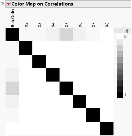

18. Open the Design Evaluation > Color Map On Correlations section.
Figure 5.66 Color Map That Shows Absolute Correlations with Run Order
The Color Map shows the following results:
– The seven continuous factors, X2 through X8, are orthogonal to each other.
– Run Order, the linear time trend variable, has extremely low absolute correlation with X2 through X8.

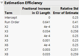

19. Open the Design Evaluation > Estimation Efficiency section.
Figure 5.67 Estimation Efficiency
The small absolute correlations of Run Order with X2 through X8 result in very small increases in confidence interval lengths, relative to an ideal orthogonal design. The increases in the lengths of confidence intervals for X2 through X8 are all less than about 0.1%.
In this example, the run order factor is nearly orthogonal to the factor effects. In some cases, your design might have more substantial correlations between the run order factor and other factors. Even in such a situation, including the run order as a factor accounts for any linear trend effect. Including the run order also allows for more precise estimation of the other factor effects.
