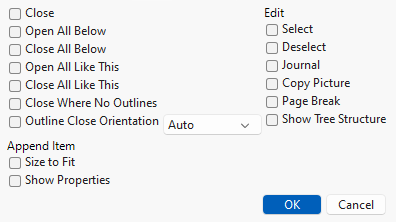

An alternative way to access these options is to press Alt and right-click the disclosure icon Image shown here. This displays a window, as shown in Figure 9.3, with check boxes for options so that you can select multiple actions at the same time. You can also do the same to access the red triangle menu options.
Figure 9.3 Outline Box Menu Items Window
