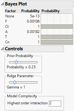

Use the Standard Least Squares personality of the Fit Model platform to determine which factors in an experimental design are active. Use a Bayes plot to identify active factors. One type of Bayes plot is available as an option under Effect Screening in the Response red triangle menu. This example illustrates a script that uses an alternative formulation of the Bayesian approach and allows for the possible models to include higher-order terms in constructing the Bayes plot.

Figure 4.61 Bayes Plot for Factor Activity
The Model Complexity indicates that the highest order interaction to consider is two. Therefore, all possible models that include up to second-order interactions are constructed. Based on the value assigned to Prior Probability, a posterior probability is computed for each of the possible models. The probability for a factor is the sum of the probabilities for each of the models where it was involved.
This approach identifies Ct, T, and Cn as active factors, and A and F as inactive.
