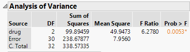

5. Click the Oneway Analysis red triangle and select Means/Anova.
Figure 10.10 Analysis of Variance Report
Notice that the F ratio is 6.2780.

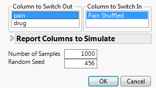

6. In the Analysis of Variance outline, right-click the F Ratio column and select Simulate.
7. In the Column to Switch Out list, click pain.
8. In the Column to Switch In list, click Pain Shuffled.
9. Next to Number of Samples, enter 1000.
10. (Optional) Next to Random Seed, enter 456.
This reproduces the values in this example.
Figure 10.11 Completed Simulate Window
11. Click OK.

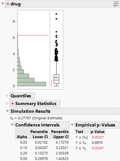

12. In the table of simulated values, run the Distribution script.
Figure 10.12 Simulated Distribution of F Ratios under the Null Distribution
The observed F ratio value of 6.2780 is represented with a red line in the histogram. This value falls in the upper 0.5% of the simulated null distribution of F ratios. This presents strong evidence that the three drugs differ in their effects on pain.
