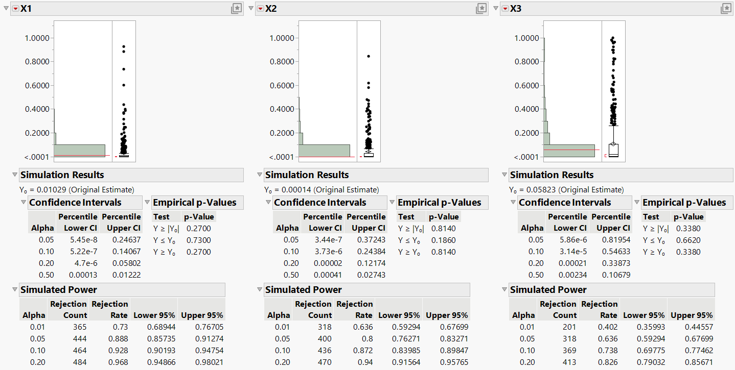

Figure 10.1 Power Analysis Using Simulate
