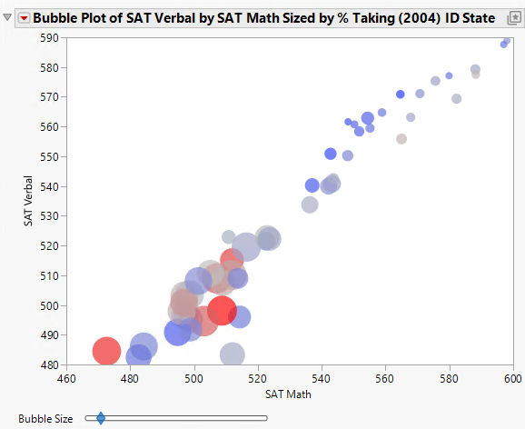

Figure 5.11 The Static Bubble Plot Report Window
You draw the following conclusions:
• Higher verbal scores appear to be associated with higher math scores because the two track very closely in the bubble plot. This track signifies a correlation between verbal and math scores.
• The larger bubbles represent the US states that had a high percentage of individuals that took the SAT test in 2004. These larger bubbles are all grouped together in the lower left of the graph. This graph shows that when a state had a high percentage of individuals that took the test, both the math and verbal scores were low.

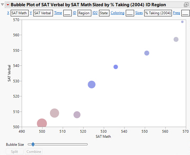

Instead of grouping the bubbles primarily by state, group the bubbles primarily by region:
1. Click the Bubble Plot red triangle and select Show Roles.
2. Click the ID link.
3. Select Region and click OK.
Region is now the primary ID variable.
4. Click the ID2 link.
5. Select State and click OK.
State is now the secondary ID variable.

Figure 5.12 Example of Bubble Plot Grouped by Region and State

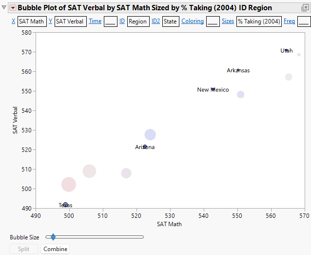

8. Click the bubble that represents the Southwest region (hover over a bubble or click it to see its label).
9. Click Split.
Now the bubbles are split by the secondary ID variable, which is State. You see each state within the Southwest region.
Figure 5.13 Example of Southwest Region Split by State
Notice that there is significant variation in the scores among the Southwest states.

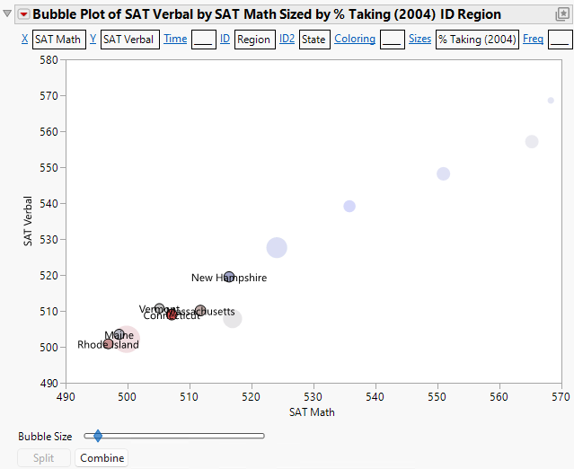

11. To do a comparison, click the New England bubble (hover over a bubble or click it to see its label).
12. Click Split.
Figure 5.14 Example of New England Region Split by State
Notice that the New England states do not have as much variation as the Southwest states.
