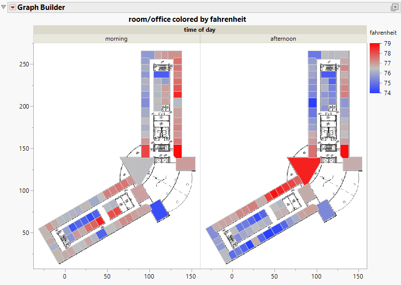

Figure 12.36 shows the floor, grouped by time of day. The color reflects the Fahrenheit value. Exploring data visually in this way can give hints as to what factors are affecting office temperature. Looking at this map, it appears that the offices on the east side of the building are warmer in the mornings than they are in the afternoons. On the western side of the building, the opposite appears to be true. From this visualization, you might expect that both of these variables are affecting office temperatures, or perhaps that the interaction between these terms is significant. Such visuals help guide decision-making during the analysis.
Figure 12.36 Room/Office Colored by Fahrenheit and Grouped by Time of Day

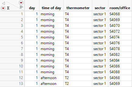

First, data were collected and entered into a data table (S4 Temps.jmp). Note the Room/Office column. This column contains the unique names for each office and was assigned the Map Role to correctly define the map files.
Figure 12.37 Partial View of the S4 Temps.jmp Data Table

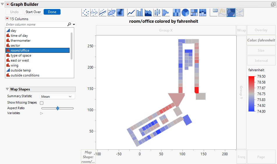

After the Map Role column property is set up, you can perform your analysis. You want to visually see the differences in office temperatures throughout the floor.
1. Select Graph > Graph Builder.
2. Drag and drop room/office into the Map Shape zone.
Because you defined the Map Role column property on this column, the map appears.
3. Drag and drop fahrenheit to the Color zone.
Figure 12.39 Room/Office Colored by Fahrenheit

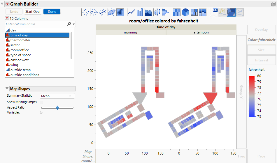

4. Drag and drop time of day onto the Group X zone.
Figure 12.40 Room/Office Colored by Fahrenheit and Grouped by Time of Day
Note that only the offices that were part of the study and were created by using the Custom Map Creator add-in are displayed. To add the entire floor plan image, the original floor plan graphic was dragged and dropped onto the Graph Builder window to create Figure 12.41.
To view Figure 12.41, select Help > Sample Data Folder, open S4 Temps.jmp, and run the by Time of Day script.
Figure 12.41 Room/Office Map with Original Floor Plan
