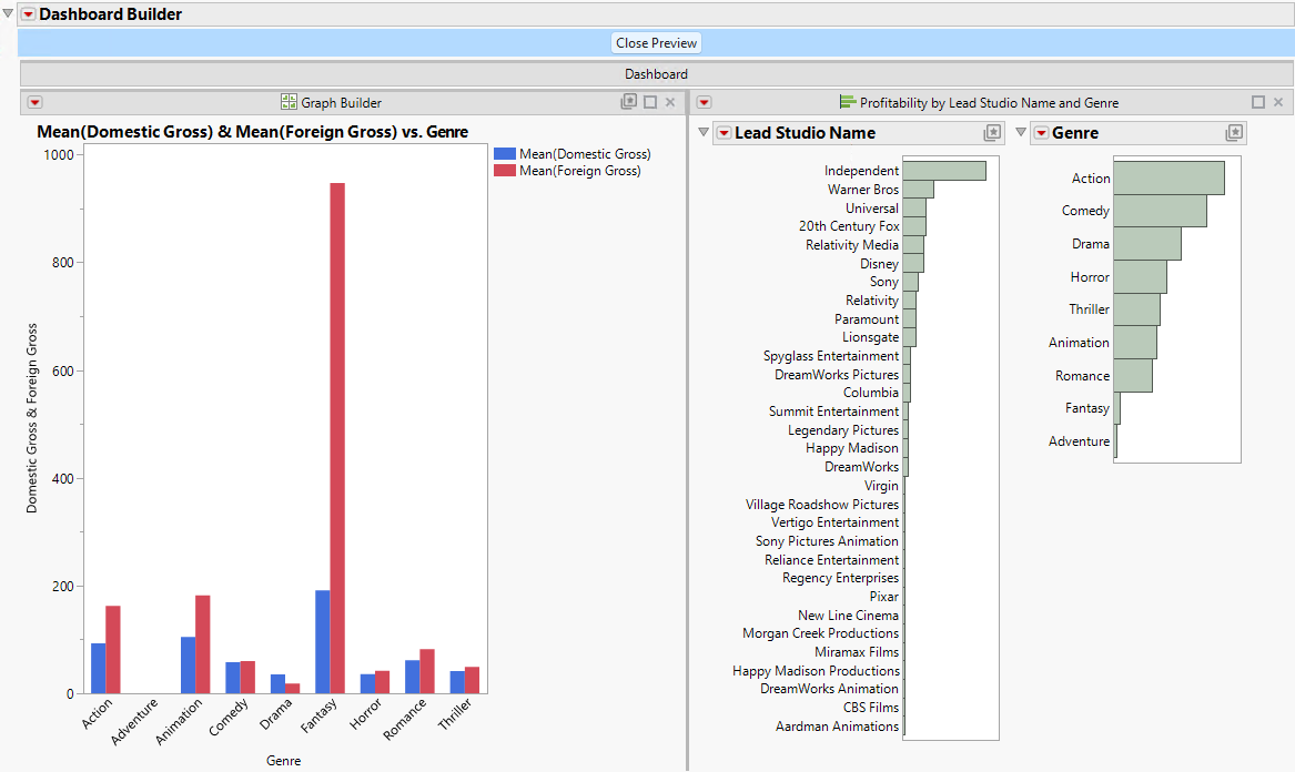

5. In the Reports list, double-click the report thumbnails to put them on the dashboard (Figure 12.3).
6. Click the Dashboard Builder red triangle and select Preview Mode.
A preview of the dashboard appears (Figure 12.2). Notice that the graphs are linked to each other and the data table. They also have the same red triangle options as the Distribution and Graph Builder platforms.
Figure 12.2 A Dashboard with Two JMP Reports
