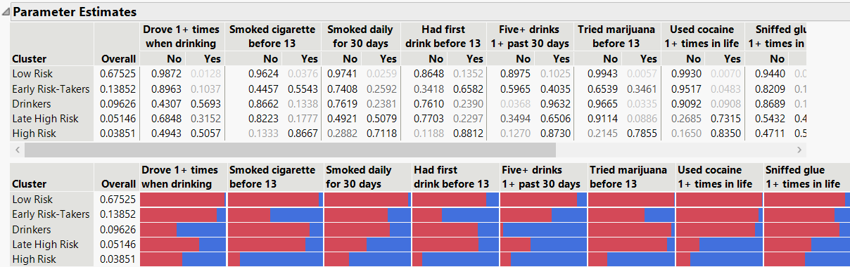

Figure 16.3 Partial Parameter Estimates Report
Figure 16.3 shows parameter estimates for the first eight variables in the analysis. The new cluster names appear in the report window.

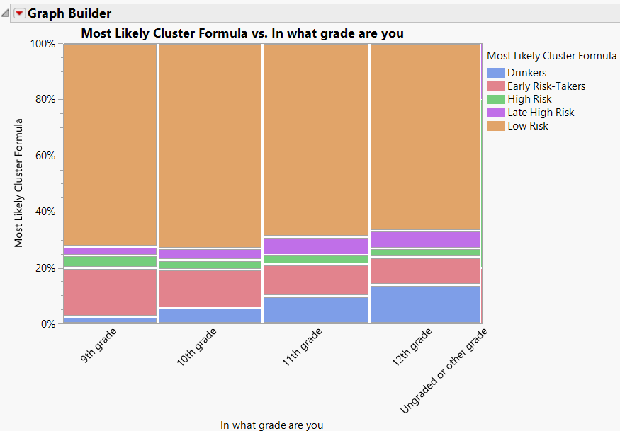

Next, compare cluster membership to the demographic question “In what grade are you”.
8. Click the red triangle next to Latent Class Model for 5 Clusters and select Save Mixture and Cluster Formulas.
9. Select Graph > Graph Builder.
10. Enter In what grade are you as X.
11. Enter Most Likely Cluster Formula as Y.
12. Select the Mosaic element.
13. Click Done.
Figure 16.4 Mosaic Plot of Cluster Membership versus Grade Level
Observe that most of the respondents fall into the Low Risk cluster. The class labeled Drinkers includes more respondents as the grade level increases.
