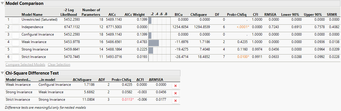

Figure 8.29 Model Comparison and Chi-Square Difference Test Reports
The Model Comparison and Chi-Square Difference Test reports enable you to assess model fit across the different levels of measurement invariance. Among the tested models, the Strong Invariance model has the most evidence of best fit. This model constrains both factor loadings and intercepts to be equal across groups, which provides meaningful comparisons of latent means across genders. The CFI (0.9974) and RMSEA (0.0456) values for this model indicate an acceptable model fit. Moreover, despite the large sample size, the Chi-Square Difference Test report indicates that there is no significant difference between the Strong Invariance model and the less restrictive Weak Invariance model. This suggests that the Strong Invariance model fits the data well without sacrificing model fit. Although the Strict Invariance model (which also constrains residual variances to be equal across groups) was tested, this level of invariance is generally not necessary for meaningful cross-group comparisons of latent means. The significant drop in model fit from the Strong Invariance model to the Strict Invariance model suggests that equal residual variances across groups might be too restrictive and unnecessary. Therefore, you choose to use the Strong Invariance model as the final model, which is sufficient for comparing latent means across groups.
