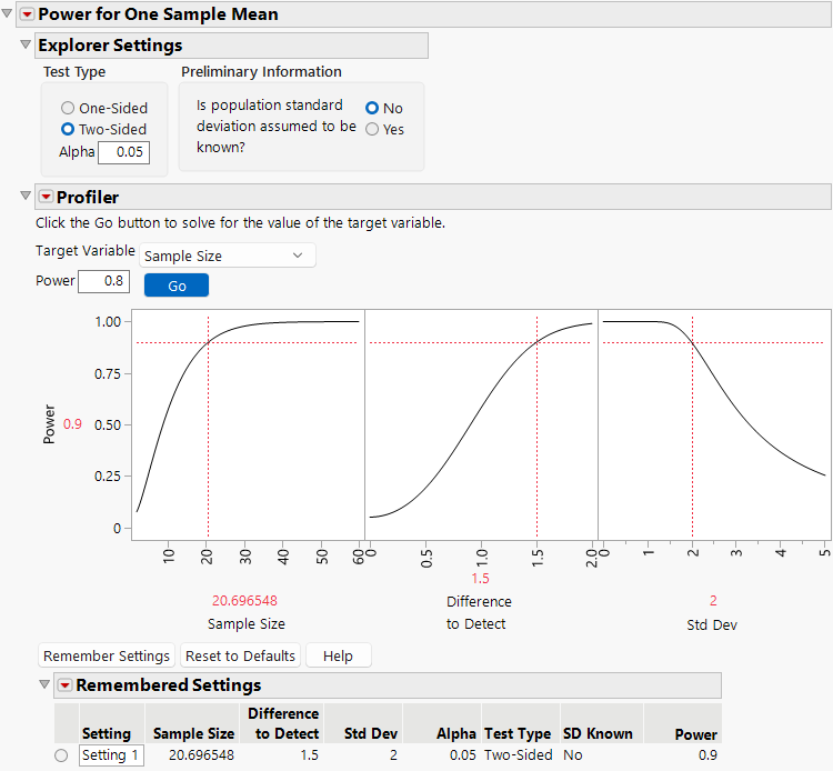

7. Above the profiler, leave the target variable as Sample Size, enter 0.9 for Power, and click Go.
Note that a sample size of 21 is needed.

Figure 29.2 One Sample Mean Power Explorer
At a significance level of 0.05, 21 fabric samples are needed to have a 90.4% chance of detecting a significant difference of 1.5 seconds in the burn time from the current 2 seconds.
