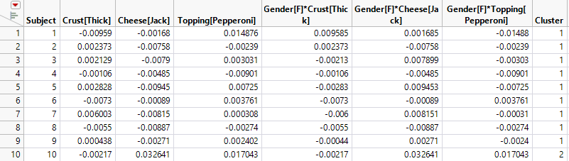

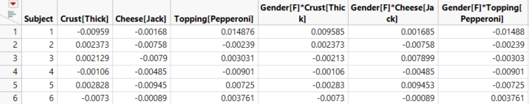

3. Click the Choice Model: Choice red triangle and select Save Gradients by Subject.
A data table appears with gradient forces saved for each main effect and subject interaction.
Figure 4.33 Gradients by Subject for Pizza Data, Partial View

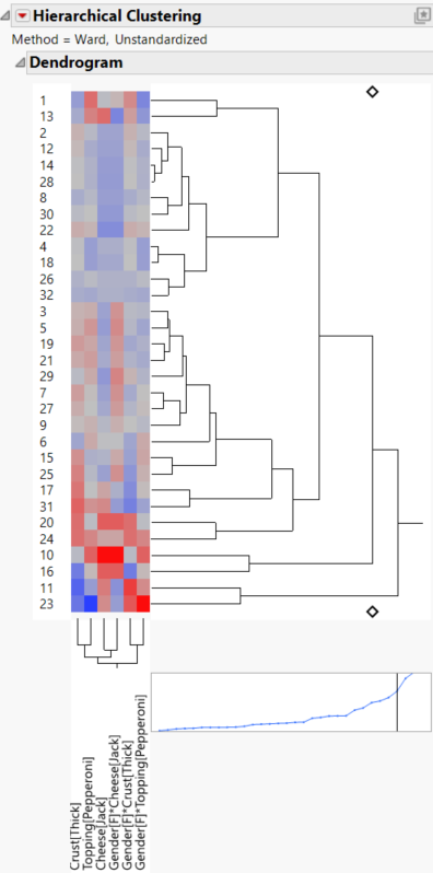

4. Click the green triangle next to the Hierarchical Cluster script.
Figure 4.34 Dendrogram of Subject Clusters for Pizza Data
The script runs a hierarchical cluster analysis on all columns in the gradient table, except for Subject. Click either diamond to see that the rows have been placed into three clusters.

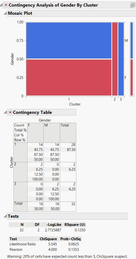

Figure 4.36 Contingency Analysis of Gender by Cluster
Observe the following patterns in the clusters:
– Cluster 1 is evenly divided between males and females.
– Cluster 2 consists of only females.
– Cluster 3 consists of only males.
