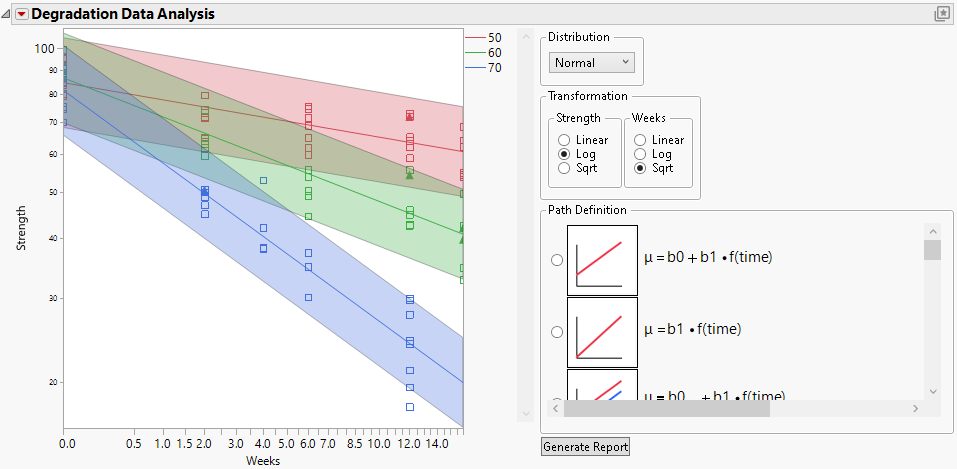

Change the Model and Generate the Report
1. Select Log for the Y (Strength) Transformation.
2. Select Sqrt for the Time (Weeks) Transformation.
3. Select μ = b0x + b1x*f(time) for the Path Definition.
The subscript “x” denotes the accelerating variable, which is Degrees in this example.
Note: This model is linear in all parameters.
Figure 10.3 Plot That Shows Model

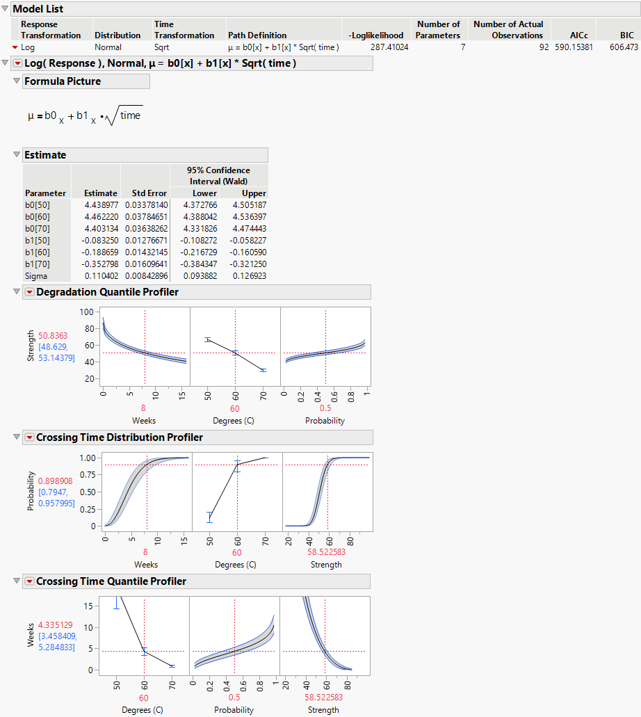

4. Click Generate Report.
Figure 10.4 Report for Basic Model
The estimates of the slope b1 at the three values of Degrees suggest that degradation occurs more quickly at higher temperatures. Failure mechanisms that depend on chemical processes are often well modeled using the Arrhenius model for temperature. For this reason, you now fit a model where an Arrhenius transformation is applied to Degrees, which is measured on a Celsius scale.

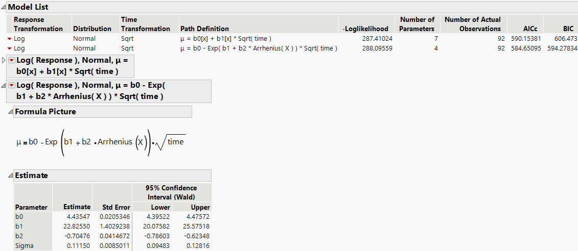

5. Select μ = b0 ± Exp(b1 + b2*Arrhenius(X))*f(time) for the Path Definition.
Note: This model is not linear in the parameters.
6. Select Celsius and click OK.
Figure 10.5 Plot That Shows Model with Arrhenius Transformation
7. Click Generate Report.
Figure 10.6 Report That Includes Second Model with Arrhenius Transformation
Use the Profilers for Prediction
Because the Arrhenius model shows a better fit, as indicated by its smaller AICc and BIC values (Figure 10.6), you continue your analysis using this model.

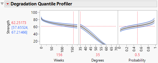

1. In the Degradation Quantile Profiler for the Arrhenius model, set Weeks to 156 and Degrees to 35.
Figure 10.7 Degradation Quantile Profiler
The predicted median strength at these settings is 62.25, with a lower confidence limit of 57.66. Failures are not very likely at these or less extreme settings.

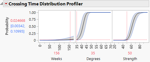

2. In the Crossing Time Distribution Profiler, set Weeks to 156, Degrees to 35, and Strength to 50.
Figure 10.8 Crossing Time Distribution Profiler
At 156 weeks at a temperature of 35 degrees Celsius, the probability that the value of Strength is less than 50 is 0.024668. The 95% confidence interval ranges from 0.00342 to 0.10995. The probability of failure at these or less extreme conditions is about 2%.

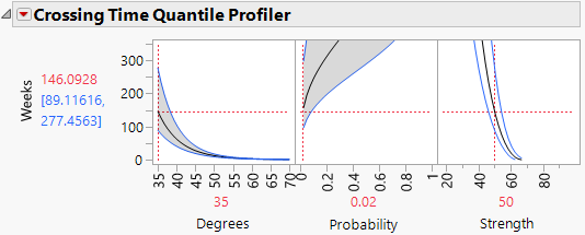

3. In the Crossing Time Quantile Profiler, set Degrees to 35, Probability to 0.02, and Strength to 50.
4. Adjust the vertical axis of the Crossing Time Quantile Profiler so that the maximum value is about 350.
Figure 10.9 Crossing Time Quantile Profiler
The number of weeks within which 2% of units fail at a temperature of 35 degrees Celsius is estimated to be 146.09.The 95% confidence interval ranges from 89.12 to 277.46.
