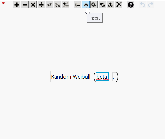

5. In the formula editor, select Random > Random Weibull.
6. The placeholder for beta is selected. Click the insertion element (^).
Figure 9.28 Formula Editor for Simulated Purity Column
This adds a placeholder for the parameter alpha.

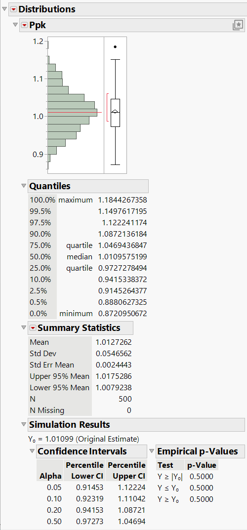

11. In the Process Capability Simulate Results (Estimate) data table, click the green triangle next to the Distribution script.
Figure 9.30 Distribution of Simulated Ppk Values for Purity
Note: Your values might vary slightly from what is shown, depending on the decimal precision of the parameters in the Simulated Purity column formula.
Two Distribution reports are shown, one for Ppk and one for Ppl. But Purity has only a lower specification limit, so that the Ppk and Ppl values are identical. For this reason, the Distribution reports are identical.
The Simulation Results report shows that a 95% confidence interval for Ppk is 0.915 to 1.122. This indicates that the true Ppk value could be above 1.0, which would place Purity above the Ppk = 1 line in the Capability Index Plot you constructed in Nonnormal Capability Analysis.

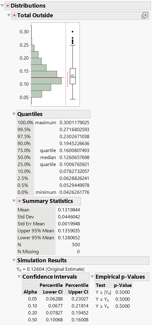

16. In the Process Capability Simulate Results (Expected Overall %) data table, click the green triangle next to the Distribution script.
Figure 9.31 Distribution of Simulated Total Outside Values for Purity
Again, two identical Distribution reports appear. The Simulation Results report shows that a 95% confidence interval for the Expected Overall % nonconforming is 0.063 to 0.230.
