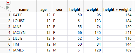

In spreadsheets, formulas apply to a single cell and can use data from any cell in the spreadsheet, including cells on different tabs of the workbook. In JMP data tables, formulas apply to an entire column. A formula can use data from any other column in the data table. Each row in the column has the same calculation applied to it. For example, consider a data table with a simple sum, as shown in Figure 2.11. The column height + weight has a formula. The formula adds the height and weight by row for all rows in the data table.
Figure 2.11 Data Table with Formula Column
