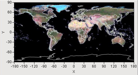

Figure 12.17 Examples of Simple and Detailed Maps
As its name suggests, Simple Earth is a relatively unadorned image of the Earth’s geography. It does not show clouds or arctic ice, and it uses a green and brown color scheme for the land and a constant deep blue for water. Detailed Earth has a softer color scheme than Simple Earth. It has lighter greens and browns for the land and variation in the blue for the water. Detailed Earth also has a slightly higher resolution than Simple Earth. The higher resolution lets you zoom in to a graph further with Detailed Earth than with Simple Earth before the quality of the background image begins to blur.

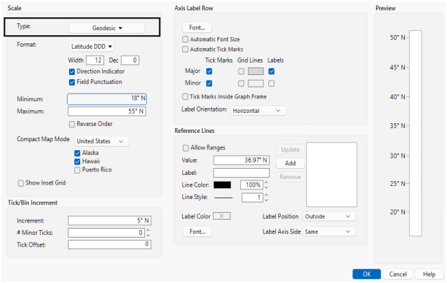

1. Right-click the X or Y axis and select Axis Settings.
2. Make sure that the Scale Type is set to Geodesic.
Figure 12.18 Y Axis Setting Window

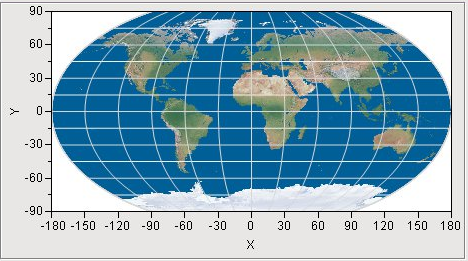

It is important to note that you must set the scale to Geodesic for both axes to get the transformation. You do not see a change in the map after setting only one of the axes. In the following figure, Simple Earth is used as the background map with both axes set to use a geodesic scale. The axes lines are turned on as well. Notice the longitudinal lines are now curved, instead of straight.
Figure 12.19 Simple Earth Background Map - Axes Set to Geodesic Scale

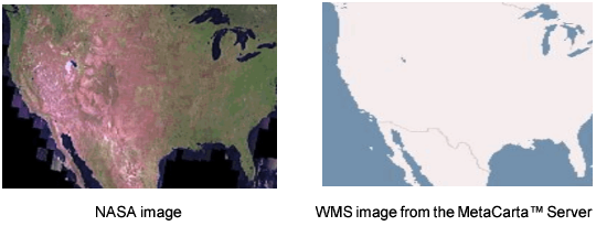

Figure 12.20 Examples of NASA and WMS Maps

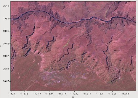

Not only does this server cover the entire Earth, but you can also zoom in on a much smaller area of the Earth and still get a reasonable map. The following figure displays the Colorado River that runs through the Grand Canyon in Arizona. The Grand Canyon Village is visible in the bottom of the map.
Figure 12.22 NASA Server Map Example - Zoom In on Colorado
If you look at the axes values, you can see that the area is less than 1/10° by 1/10°. The Simple Earth and Detailed Earth background maps do not display that type of resolution. The NASA server provides a more detailed view of any land mass on Earth. However, water is simply filled in as black. The NASA server is free to access, but it is also limited in availability. If the server is temporarily not available or becomes overloaded with requests, it delivers an error message instead of the requested map.
