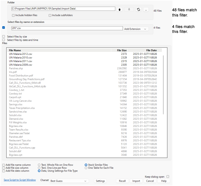

To import multiple files, follow these steps
1. Place the files that you want to import into the same directory.
This example uses import data found in the JMP Samples/Import Data folder.
2. Select File > Import Multiple Files (Windows) or File > Open Multiple (Apple macOS).
3. Browse to select the JMP Samples/Import Data folder.
4. In the Select Files by name or extension box, type UN*.csv and press Enter.
In this example, the files have the UN prefix and are CSV files.
The Files list updates to show which files have been selected.
Specify multiple file names and extensions by separating them with semicolons, or click Add Extension and select an extension.
Figure 3.19 Selected CSV Files
Selected CSV Files
Notice that the Refresh button Image shown here flashes if the files have changed in the directory since the last refresh.

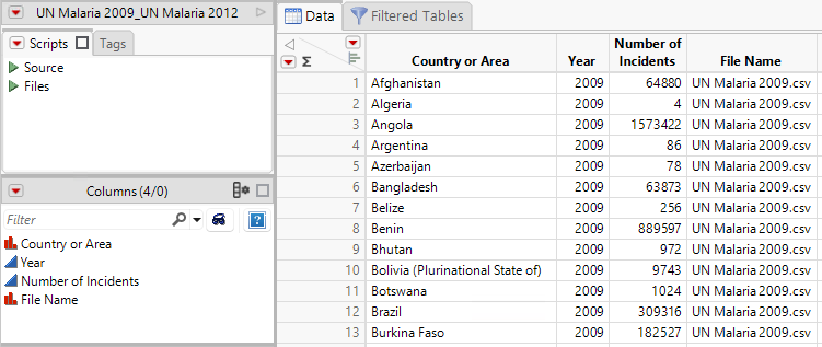

5. Specify the columns that you want added to the data table.
By default, no extra columns are added. You might want a File Name column to show the names of the imported files. Select Add file name column.
Note: The Text Data Files preferences do not determine which options are selected in the CSV settings, although the settings are similar.
6. Keep Stack Similar Files selected because these CSV files have the same columns.
7. Click Import.
JMP applies the file name, file size, and file date and time filters to stack the files. Data with columns that contain the same column headers are imported in the same data table. If the columns do not match, the mismatched columns are imported into a separate data table.
Figure 3.20 Imported CSV Data
Imported CSV Data
