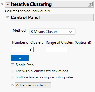

Figure 14.7 Iterative Clustering Control Panel
