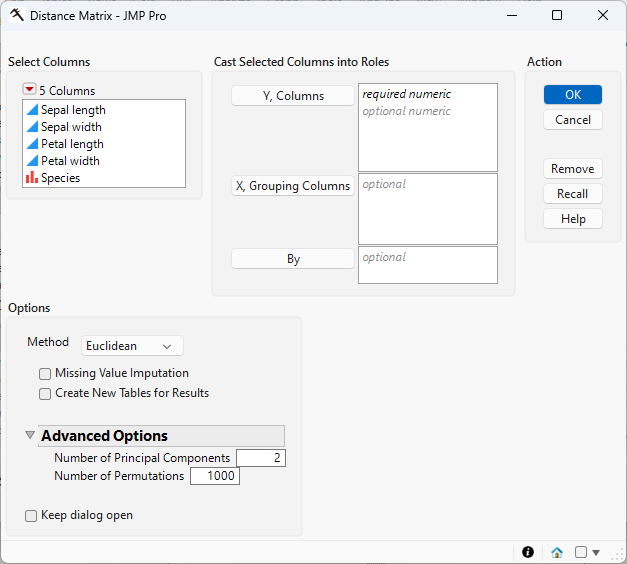

Launch the Distance Matrix platform by selecting Analyze > Life Sciences > Distance Matrix.
Figure 9.2 The Distance Matrix Launch Window

Y, Columns
Select the feature columns that you want, and click Y, Columns to specify the features that you want to consider in computing distances between observations or rows.
X, Grouping Columns
Specifies the column that defines groups for PERMANOVA analysis. Use this option to compute PERMANOVA results based on the selected grouping column, using the previously computed distance matrix.
By
Generates a separate report for each level of the By variable. If more than one By variable is assigned, a separate report is generated for each possible combination of their levels.

Missing Value Imputation
Check this option when there are missing values to be imputed.
Create New Tables for Results
Check this option to create new tables for the output data and results. When this option is not checked, output is added to the end of the input data table.
Number of Principal Components
Use this option to specify the number of principal components to calculate. All of the specified principal components are added to the output table. Note that only the first two PCs are plotted.
Number of Permutations
Use this option to specify the number of permutations for computing PERMANOVA results.
Keep dialog open
Check this box to keep this platform window open after the analysis is run.
