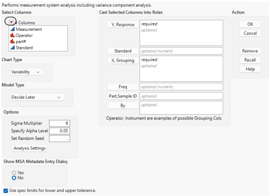

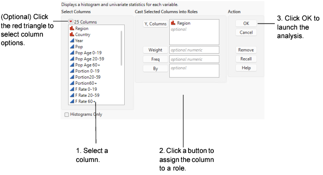

The launch window is your entry point into a platform, where you specify the columns to analyze. Figure 2.11 shows the Distribution launch window.
Figure 2.11 Launch Window Features
All launch windows have the following options in common:
Select Columns
Lists all of the variables in your current data table. Note the following points:
– Right-click the modeling type icon next to a column name to change the modeling type.
– Right-click the column name to create a transform column. See “Transform Columns in a JMP Platform”.
– Filter and sort the columns by using the options in the red triangle. See Column Filter Menu.
Cast Selected Columns into Roles
Moves selected columns into roles (such as Y, X, and so on). You cast a column into the role of a variable (like an actor is cast into a role). See Cast Selected Columns into Roles Buttons.

Action
The following options are available:
OK
Performs the analysis.
Cancel
Stops the analysis and closes the launch window.
Remove
Deletes any selected variables from a role.
Recall
Populates the launch window with the last analysis that you performed.
Help
Takes you to the Help for the launch window.
Tip: To reopen the platform launch window that was last opened, select View > Recall Last Platform (Windows) or Window > Recall Last Platform (Apple macOS).
