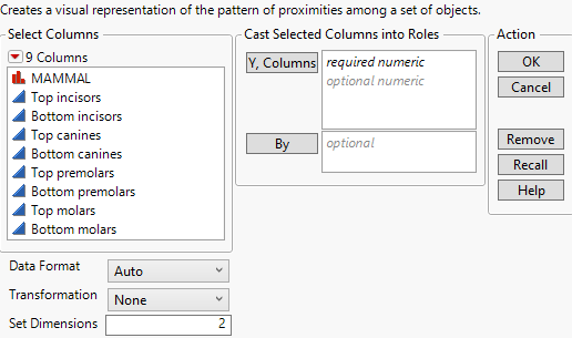

Launch the Multidimensional Scaling platform by selecting Analyze > Multivariate Methods > Multidimensional Scaling.
Figure 10.4 Multidimensional Scaling Launch Window
Y, Columns
The columns to be analyzed. These must have a Numeric data type.

Data Format
MDS supports two data formats. You can specify a format or allow JMP to infer the data format.

Transformation
Supported transformations are Ratio, Interval, and Ordinal.

Set Dimensions
The number of dimensions for the visual representation of the proximities among your objects. Typically, two or three dimensions are used. With greater than three dimensions, the visualization becomes complex.
