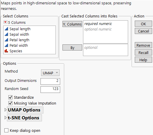

Launch the Multivariate Embedding platform by selecting Analyze > Multivariate Methods > Multivariate Embedding.
Figure 11.3 Multivariate Embedding Launch Window
For more information about the options in the Select Columns red triangle menu, see “Column Filter Menu” in Using JMP. The Multivariate Embedding launch window contains the following options:
Y, Columns
Specifies columns that represent the high-dimensional data to be mapped into a low-dimensional space.

Method
Specifies the method for mapping the data into a low-dimensional space. Choose between UMAP and t-SNE.
Output Dimensions
Specifies the number of components or dimensions in the low-dimensional space. The number of components must be greater than or equal to 2.
Random Seed
Specifies a random seed to reproduce the results for future launches of the platform.
Standardize
Standardizes the data internally prior to computing the distances that are used in dimension reduction.
Missing Value Imputation
Specifies that missing values in the data are imputed using a multivariate singular value decomposition (SVD) technique.
