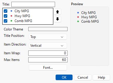

Legend Settings Window
Change aspects of the legend through the Legend Settings window.
Figure 3.46 Example of the Legend Settings Window
Title
The name of the legend.
Check boxes
Shows or hides items in the legend. JMP hides items that appear to be redundant, but you can make them appear by selecting them. If your legend has a large number of entries, some might be hidden in the Graph Builder window to ensure sufficient space for the graph. However, all of the entries appear here, so you can select the ones that you want to show. To select or deselect all entries, right-click and select Toggle check box.
Up and down arrows
Changes the order of items in the legend.
Color Theme
Select a different color theme. For more information about color themes, see “Create Color Themes in Graphs” in Using JMP.
Title Position
Places the legend title on top or to the left of the items in the legend.
Item Direction
Displays the legend horizontally or vertically.
Item Wrap
Sets the legend to be n items tall (if vertical) or n items wide (if horizontal).
Max Items
Enables you to set a maximum number of legend items.
Font
Changes the font type, style, and size.
Preview
Shows your changes to the legend.
OK
Commits your changes to the legend.
Cancel
Cancels your changes to the legend.
Help
Opens the online Help.

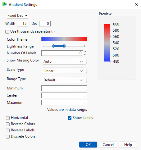

Gradient Settings
You can change various aspects of the gradient legend in the Gradient Settings window.
Figure 3.47 Gradient Settings Window
To format the labels in the legend, use the menu, Width and Dec boxes, and the Use thousands separator (,) check box in the upper left of the window.
Color Theme
Change the color theme or define a custom color theme. For more information about color options, see “Create Color Themes in Graphs” in Using JMP.
Lightness Range
Set the range of intensities for the gradient coloring.
Number of Labels
Specify the number of labels for your legend. The value of zero provides the default number of labels.
Show Missing Color
Specifies whether to show missing color in the legend. Auto shows the color only when there are missing values, Off never shows the color, On always shows the color.
Scale Type
Sets the scale for the gradient coloring. Look below the Maximum option for a description of the scale type.
Linear
The scale is piecewise linear between the Minimum and Center values and between the Center and Maximum values. This option is the default scaling.
Quantile
The scale is piecewise linear for quantiles of the variable that is represented by the legend.
Standard Deviation
The legend range is divided into offsets from the mean that is determined by standard deviation increments. The scale is piecewise linear between these offset settings. The number of offsets is determined by the Number of Labels.
Log
The scale is linear for the logarithm of the values that are represented by the legend.
Log Offset
The scale is linear for the offset of the base 10 logarithm of the values that are represented by the legend.
Custom
If a continuous variable is used as the overlay variable, you can customize the bin values for the gradient.
Range Type
Sets the range of the legend values.
Default
Unless you specify values for the Minimum and Maximum, the minimum and maximum values include the range of the data and are chosen to be appropriately rounded values.
Exact Data Range
The minimum and maximum values are the exact minimum and maximum values for the data, or they are the values that you specify as Minimum and Maximum.
Middle 90%
The minimum and maximum values are the 5th and 95th quantiles, or they are the values that you specify as Minimum and Maximum. This option is resistant to outliers.
Minimum, Center, Maximum
Specify the smallest, middle, and largest values to use for your legend scaling.
Note: These values can override the Range Type values.
Horizontal
Changes the orientation of the legend to horizontal.
Reverse Colors
Reverses the colors in the color scheme.
Reverse Labels
Reverses the scale for the color theme.
Discrete Colors
Changes the color scheme from a continuous gradient to a stepped gradient with discrete colors.
Show Labels
