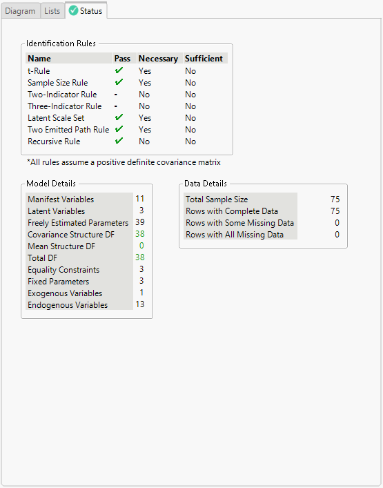

Image shown hereStatus Tab
The Status tab contains checks for model identifiability. Structural equation models must be identified to obtain reliable estimates. Identification in the context of SEM means that one can derive unique solutions for every parameter in the model based on the population covariance matrix of the input data. Because you can specify such a variety of models in the SEM framework, there are a variety of rules for identifiability. The Status tab consists of three panels of information: Identification Rules, Model Details, and Data Details.
• The Identification Rules panel contains a list of up to eight rules that are appropriate for a specified model. Some rules are necessary and others are sufficient to guarantee model identification. If necessary rules fail, steps must be taken to correct them before fitting the model. If sufficient rules fail, you do not necessarily need to address any issues. Sometimes sufficient rules can fail without being evidence of anything wrong with the model. Note that all of the rules assume a positive definite covariance matrix. If the covariance matrix is not positive definite, a warning appears below the Model Details panel.
Tip: For more information about a particular identification rule, click on the row of the table for the rule and a description of the rule appears to the right of the table.
• The Model Details panel contains a list of descriptive values for the currently specified model. These values can be used to detect potential issues with the model.
• The Data Details panel contains a list of descriptive values for the input data. These values can be used to detect potential issues with the data.
If there are singularities in the specified data columns, the report contains a Singularity Details table.
Note: When you specify a Groups variable in the launch window, the Status tab is nested within multiple group tabs. You can navigate between these tabs using the panel tabs on the left side of the Status tab. There is a Union tab that shows Lists tab for the set of group models and a panel tab for each level of the Groups variable.
The Status tab itself contains a dynamic icon that shows the current status of the specified model. The icon designates the status:
Image shown here
All applicable identification rules pass.
Image shown here
At least one necessary identification rule does not pass and you must take steps to correct the issues before fitting the model.
Image shown here
At least one non-necessary identification rule does not pass and further investigation is needed to determine whether the model is correctly specified. Often, advanced applications of SEM lead to this situation; this does not suggest a problem with the model. Rather, it suggests that the identification rules cannot guarantee that the model is identified.
Figure 8.5 Example Status Tab
Example Status Tab
