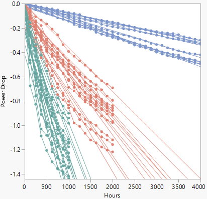

For example, the degradation paths in Figure 16.7 appear linear for the first several hundred hours, but then start to curve. To fit a nonlinear model, select Degradation Path Style > Nonlinear Path from the Degradation Data Analysis red triangle menu to show the Nonlinear Path Model Specification report (Figure 16.8).

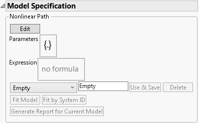

The first step to create a model is to select an option from the menu that is initially labeled Empty.

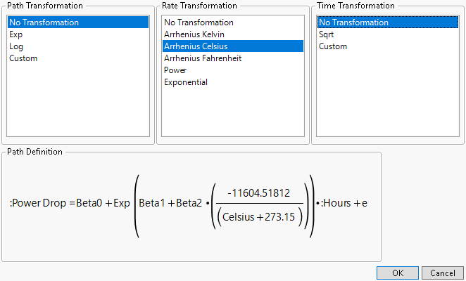

The Constant Rate option is for modeling degradation paths that are linear with respect to time (or linear with respect to time after transforming the response or time). The reaction rate is a function of temperature only.
Select Constant Rate from the menu shown in Figure 16.8. The Constant Rate Model Settings window prompts you to enter transformations for the Path, Rate, and Time.
Figure 16.9 Constant Rate Transformation
Once a selection is made for each transformation, the associated formula appears in the lower left corner as shown in Figure 16.9.
After all selections are made, click OK to return to the report. For more information about all the features for Model Specification, see Model Specification Details.

After you select one of the model types and supply the required information, you are returned to the Nonlinear Path Model Specification window.
Note: To view the Edit button displayed in Figure 16.11, you must select the interactive formula editor preference (File > Preferences > Platforms > Degradation > Use Interactive Formula Editor) before launching the Degradation platform.

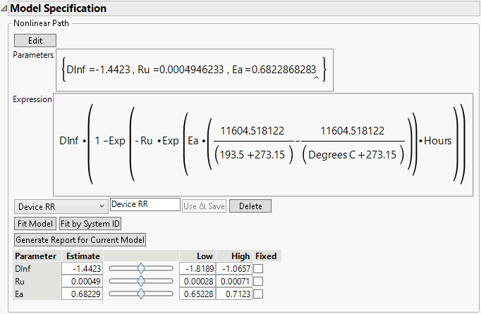

A model is now shown in the script box that uses the Parameter statement. Initial values for the parameters are estimated from the data. For more information about creating models that use parameters, see Fit a Custom Model or “Nonlinear Regression” in Predictive and Specialized Modeling.
If desired, enter a name in the text box to name the model. For this example, use the name “Device RR”. After that, click the Use & Save button to enter the model and activate the other buttons and features. Figure 16.11 shows the Model Specification window after clicking the Use & Save button.

The initial parameter values are shown at the bottom, along with sliders for visualizing how changes in the parameters affect the model. The fitted lines are shown on the Overlay plot. Move the parameter sliders to see how changes affect the fitted lines.
Here are the parameters for the Reaction Rate model (Meeker and Escobar 1998):
• Dinf (D∞) - asymptotic degradation level
• Ru (RU) - reaction rate at use temperature (tempU)
• Ea (Ea) - reaction-specific activation energy
The above parameters are calculated as follows:
D(t; temp) = D∞ × {1-exp[-RU × AF(temp) × t]}
where RU is the reaction rate at use temperature tempU, RU × AF(temp) is the reaction rate at a general temperature temp, and for temp > tempU, AF(temp) > 1
and
AF(temp) = Equation shown here
where tempUK and tempK are temperatures expressed on the Kelvin scale.
To compute the optimal values for the parameters, click the Fit Model or Fit by System ID button.
To fix a value for a parameter, check the box under Fixed for the parameter. When fixed, that parameter is held constant in the model fitting process.
