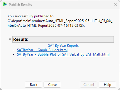

Publish Multiple Reports as Interactive HTML
To publish multiple JMP reports as interactive HTML, use the Publish to File option, which creates an index page that contains the reports.
Tip: When you publish multiple JMP reports, you specify where to save the index page and report files. You can choose a shared network folder and provide the location to others, or choose a folder on your computer and zip the files before sharing. This is particularly helpful if you are sharing with people who do not use JMP.
1. In JMP, create the reports.
Note: If a report contains a Local Data Filter, it is static in the web report and users cannot change the selections. To make the Local Data Filter interactive, deselect the Include mode. (In Graph Builder, to see the Include mode, select Show Modes from the Local Data Filter red triangle.)
2. From a report window, select File > Publish > Publish to File.
3. Select the reports that you want to publish.
4. (Optional) Change where the parent folder resides or change the name of the subfolder that will contain the reports.
5. Click Next.
6. Enter a title for the index page.
You can also update the report titles.
7. (Optional) Change additional options.
See Interactive HTML Report Options.
8. Click Publish.
Figure 11.3 Index Page for Multiple Interactive HTML Reports
9. Click a report title to open a report.
For details about working with interactive reports, from an HTML report, click Image shown here > Help. This opens the help at www.jmp.com/interactive.
