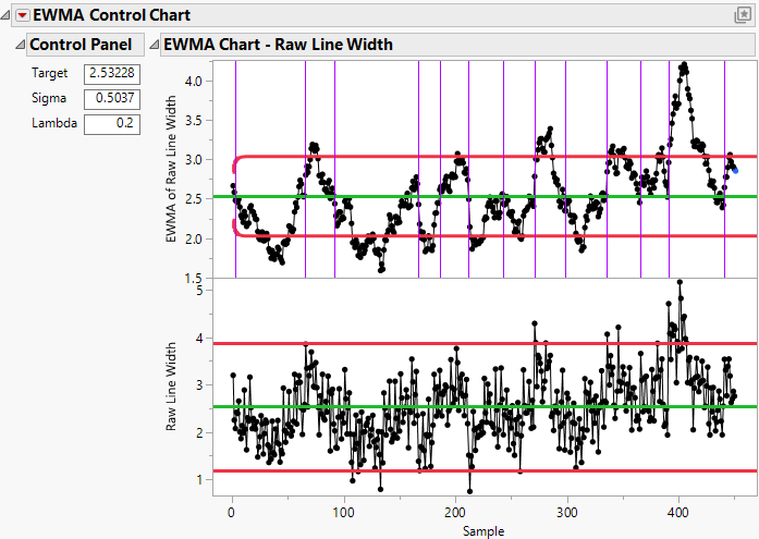

The EWMA and residuals charts can be used to identify possible seasonality and autocorrelation in a process. For example, in Figure 11.6, the peaks and valleys in the EWMA chart are evidence of seasonality in the process. The points outside limits in the residuals chart are evidence of autocorrelation. For this example, it would be appropriate to fit a time series model to the process observations and create a control chart for the residuals from the time series model. For more information about using the residuals chart for detecting autocorrelation, see Montgomery and Mastrangelo (1991).
Figure 11.6 Example of Autocorrelation and Seasonality in a Process
