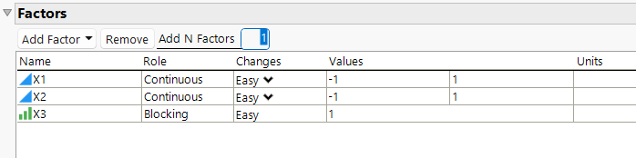

2. Type 2 next to Add N Factors.
3. Click Add Factor > Continuous.
4. Click Add Factor > Blocking > 4 runs per block.
Notice that only one level appears under Values. This is because the number of blocks cannot be determined until the number of runs is determined.
Figure 5.33 Factors with Two Continuous Factors and a Blocking Factor
5. Click Continue.
The Default number of runs is 12. The Factors section updates to show three levels for the Blocking factor, X3. Because you required X3 to have four runs per block, the 12 runs allow three blocks.

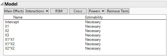

6. Click RSM.
An informational JMP Alert window reminds you that the blocking factor cannot appear in interaction or quadratic terms. JMP adds only the appropriate RSM terms to the list.
7. Click OK to dismiss the message.
Quadratic and interactions terms for X1 and X2 are added to the model. Because you added RSM terms, the Recommended optimality criterion changes from D-Optimal to I-Optimal. You can see this later in the Design Diagnostics section.

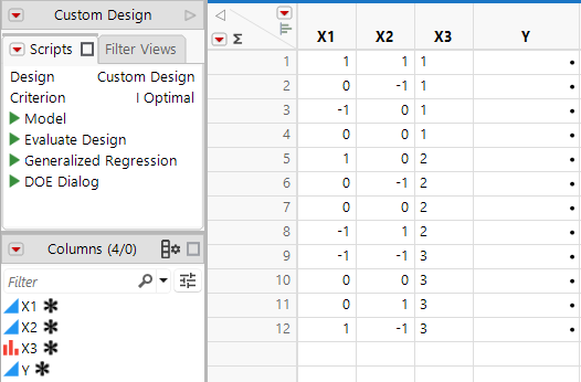

12. Click Make Table.
Figure 5.36 Design Table with Blocking Factor
Because the default Run Order was Randomize within Blocks, the levels of the blocking factor (X3) are sorted.

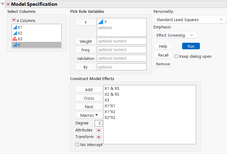

13. In the Table panel of the design table, click the green triangle next to the Model script.
Figure 5.37 Fit Model Window
Fit Model Window
Notice the following attributes of the model effects construction:
– The blocking factor (X3) is entered as an effect.
– No interactions involving X3 are included.
– The other five effects define a response surface model for X1 and X2.
