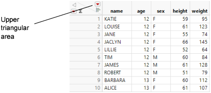

To select or deselect all columns
Press Shift and click the upper triangular area in the data grid above the row numbers to select. Click again in the same area to deselect all columns.
Figure 4.10 Upper Triangular Area
Tip: To clear all highlighted areas in the data table, press Esc.
