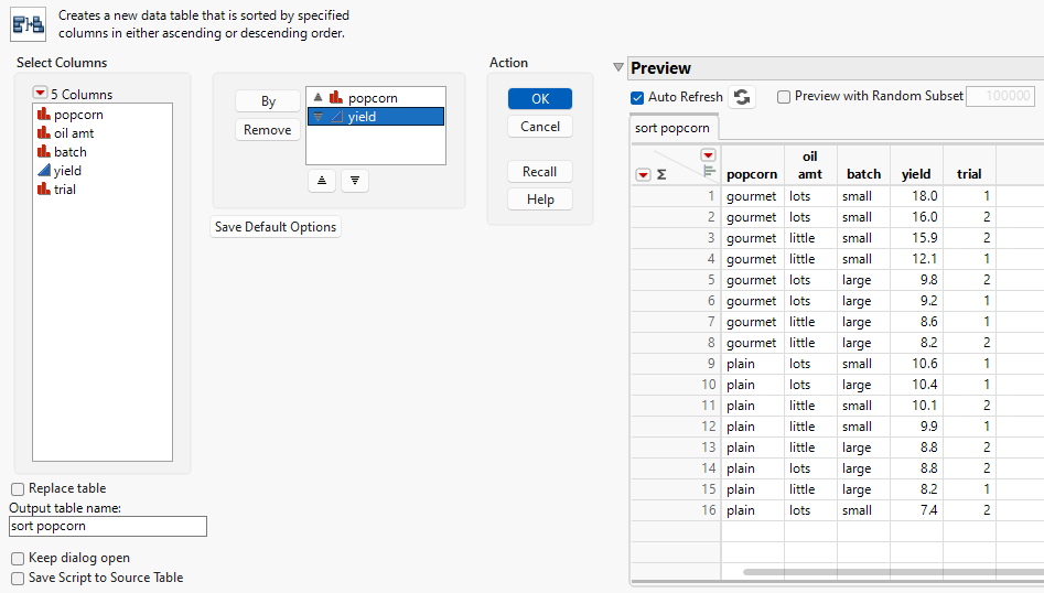

For this example, highlight yield and click the descending button Image shown here.
6. Enter a name for the new sorted table in the box beside Output table name.
For this example, enter sort popcorn.
Figure 6.6 Completed Sort Window
7. Click OK.
