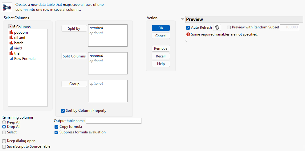

1. Select Tables > Split.
Figure 6.10 Split Window
Split Window
2. Highlight the names of the column or columns that you want to split and click Split Columns.
3. Highlight a column whose values you want to use as the basis for splitting the column.
4. Click Split By.
5. Customize your splitting further by using the additional options.
6. Click OK.
