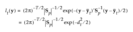

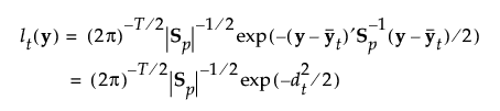

The likelihood for an observation y in group t is estimated as follows:
Equation shown here
Note that the number of parameters that must be estimated for the pooled covariance matrix is p(p+1)/2 and for the means is Tp. The total number of parameters that must be estimated is p(p+1)/2 + Tp.

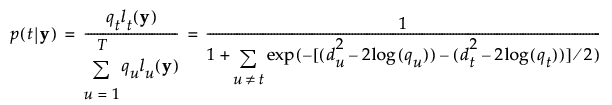

The posterior probability of membership in group t is defined as follows:
Equation shown here
An observation y is assigned to the group for which its posterior probability is the largest.

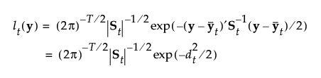

Equation shown here

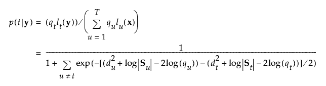

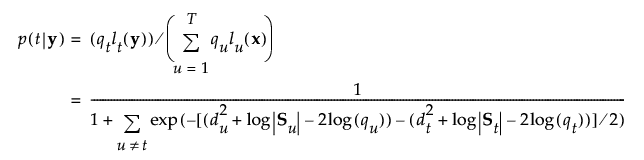

The posterior probability of membership in group t is the following:
Equation shown here

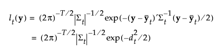

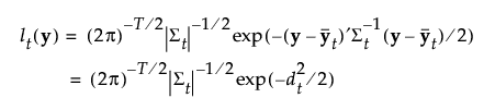

Equation shown here

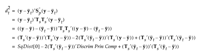

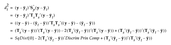

Mahalanobis Distance
The formulas for the Mahalanobis distance, the likelihood, and the posterior probabilities are identical to those in Linear Discriminant Method. However, the inverse of Sp is replaced by a generalized inverse computed using the singular value decomposition.
When you save the formulas, the Mahalanobis distance is given in terms of the decomposition. For an observation y, the squared distance to group t is the following, where SqDist[0] and Discrim Prin Comp in the last equality are defined in Saved Formulas:
Equation shown here
