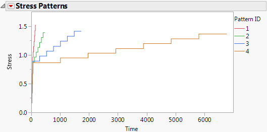

Stress Patterns Report
The Stress Patterns report in the Cumulative Damage platform shows a plot of the stress level over time for each of the stress pattern IDs. The Simulate option in this report enables you to simulate new data. Figure 7.6 shows an example of the Stress Patterns report plot. See Stress Patterns Option.
Figure 7.6 Stress Patterns Report
