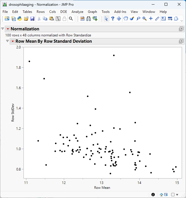

The Normalization platform does not generate a typical JMP report. Instead, columns that contain the normalized data are added either to the end of the input data table or, if you checked the Create New Tables for Results option, a separate table.
The only time that a plot is generated is when you choose the Row Standardize normalization method. In this case, a simple plot of row standard deviations by row means is displayed.
Figure 8.3 Plot Produced When Row Standardize is Selected
