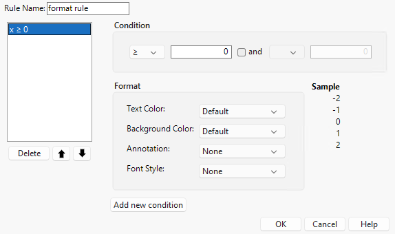

4. Click Add.
The Conditional Format Rule window appears. A placeholder rule appears on the left side of the window.
Figure 9.26 Adding a Conditional Format Rule
5. Add and format conditions as described in Add a Condition.
6. Click OK to save the new rule and return to the previous Conditional Format Rule window.

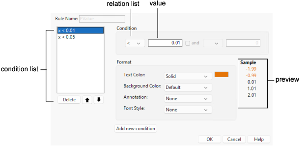

Figure 9.27 Conditional Format Rule Window
The default rule for PValue includes two conditions. The order of the list indicates the order that the rules are applied. For example, a p-value of 0.04 would not invoke the first rule (x < 0.01) but would invoke the second rule (x < 0.05).

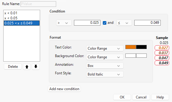

Figure 9.28 Example of Adding a Condition with Formatting Rules
6. Click OK to save your changes and return to the previous Conditional Format Rule window.
