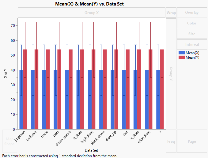

1. Select Help > Sample Data Folder and open JMP Man Dozen.jmp.
3. Select X and Y and drag them to the Y zone.
4. Select Data Set and drag it to the X zone.
5. Click the Bar element Image shown here.
6. For the Error Interval, select Standard Deviation.
Figure 9.55 Original Graph for JMP Man Dozen.jmp
Notice that the mean and standard deviation for these observations are the same, so this graph does not tell you much. Use preset graphs to get more insight into the data.

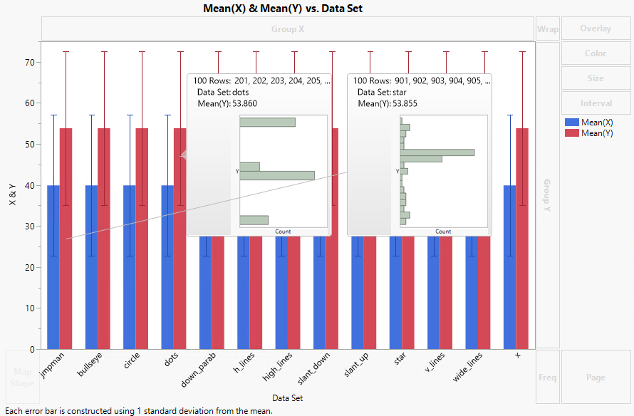

1. In the graph, right-click and select Hover Label > Histogram.
This adds preset histograms to the hover labels.
2. Point to some of the bars.
In this example, point to the red bars for dots and star.
Tip: To make the hover label remain so that you can compare it with other hover labels, click the Pin icon Image shown here in the upper right corner of the hover label. See Pin Hover Labels in JMP Graphs.
Figure 9.56 Example of Preset Histograms
Notice that the distribution for the measurements is clearly different. But you want to see another type of graph, a scatterplot.

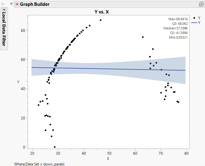

1. Hover over the blue bar for down_parab and click the graph to open it in a new window.
The graph opens in Graph Builder.
Note: Notice that when you launch a preset graph, you see a Local Data Filter on the left side of the graph. You can use the Local Data Filter to expand and change the graph. For details, see Local Data Filters in JMP Reports.
2. Click the Graph Builder red triangle and select Show Control Panel.
3. Click the Line of Fit element Image shown here.
4. Click the Caption Box icon Image shown here.
5. Under Caption Box, change the Summary Statistic to 5 Number Summary.
6. Click Done.
Figure 9.57 Customized Graph for down_parab
7. Click the Graph Builder red triangle menu and select Save Script > To Clipboard.

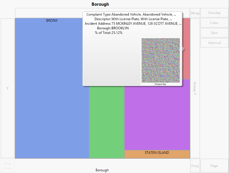

1. Select Help > Sample Data Folder and open NYC 311 Records.jmp.
These data show complaint data for boroughs in New York City.
3. Select Borough and drag it to the X zone.
4. Click the Treemap element Image shown here.
You see a treemap of the different boroughs in New York City.

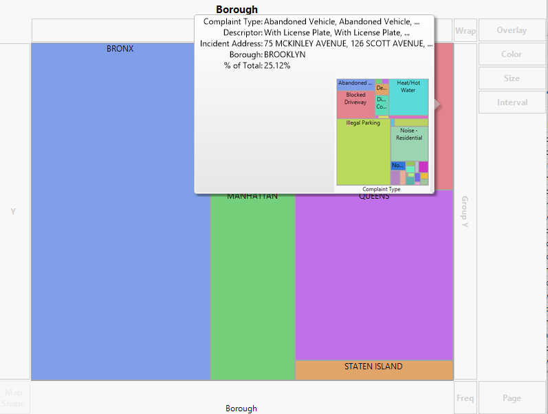

5. Right-click on the graph and select Hover Label > Treemap.
6. Put your cursor over Brooklyn to see the hover label graph.
Figure 9.58 Initial Hover Label Graph for Brooklyn
The hover label graph shows the number of incidents in each borough by the unique key. Instead, in this example, you want to see the number of incidents in each borough by the type of complaint.

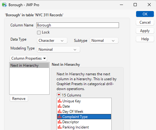

1. In the NYC 311 Records.jmp data table, right-click the Borough column heading and select Column Properties > Next in Hierarchy.
2. Under Next in Hierarchy, click Complaint Type.
Figure 9.59 Complaint Type Selected for Next in Hierarchy
3. Click OK.

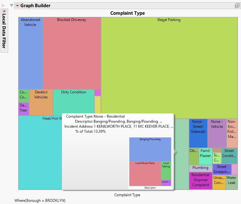

5. In Graph Builder, put your cursor over Brooklyn again to see the updated hover label graph.
Figure 9.60 Updated Hover Label Graph for Brooklyn
The hover label graph is now showing the number of incidents in each borough by the type of complaint.
6. Click the hover label graph to launch it.
7. Put your cursor over Noise-Residential.
Figure 9.61 Second Level Hover Label Graph for Residential Noise Complaints
The second level of the hover label graph is showing the number of incidents in the residential noise complaints category by the descriptor.

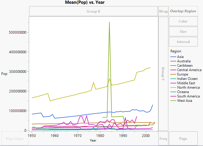

Figure 9.62 Mean Population by World Region Per Year
This graph shows the mean population in each world region over different years. In the hover label graphs, you want to see a more granular view that shows the impacts by country instead of region.

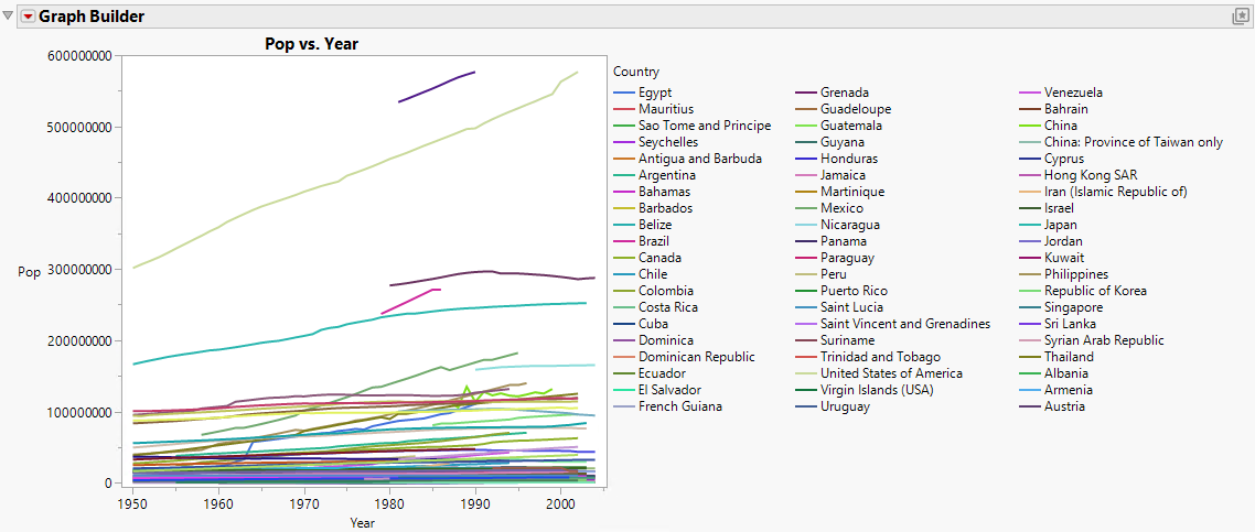

2. In the copy of the graph, select Country and drag it to the Overlay zone.
This replaces Region with Country.
3. Click Done.
Figure 9.63 Mean Population by Country Per Year
4. Click the Graph Builder red triangle and select Save Script > To Clipboard.
5. Close this graph.
6. In the original graph, right-click and select Hover Label > Paste Graphlet.

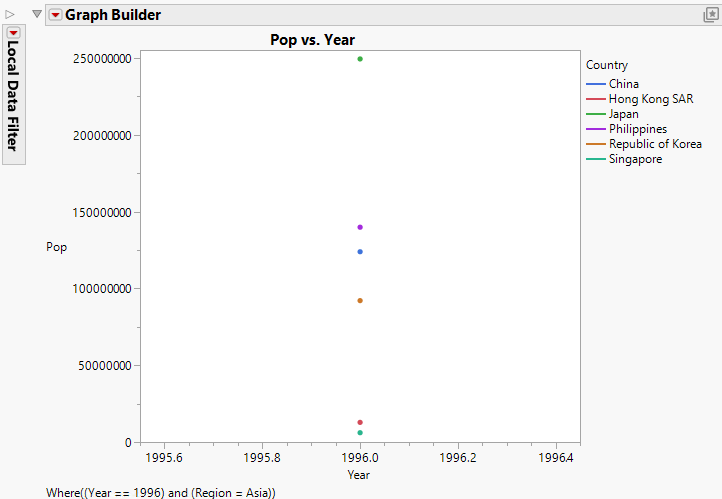

7. Hover over the Asia line and click to launch the hover label graph.
Figure 9.64 Hover Label Graph That Shows Population by Country and Year for the Asia Region
Because you are still filtering by year, this view is too granular to be useful. You want to remove the year filter, so that the graph filters only by region.

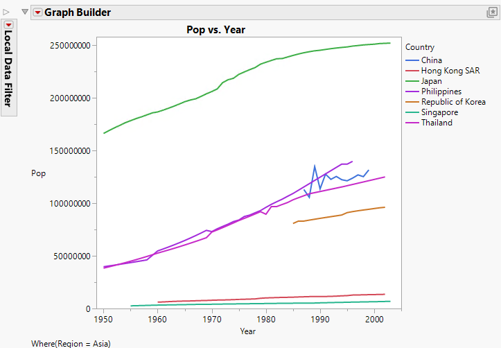

5. Hover over the Asia line and click to launch the hover label graph.
Figure 9.66 Hover Label Graph That Shows Population by Country and Year for the Asia Region
Notice that the hover label graphs are no longer filtering by year, but by region only, creating a more useful visualization.

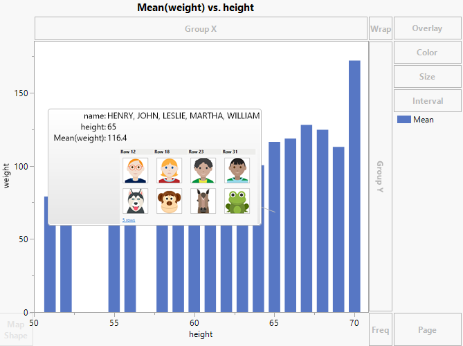

1. Select Help > Sample Data Folder and open Big Class Families.jmp.
3. Select weight and drag it to the Y zone.
4. Select height and drag it to the X zone.

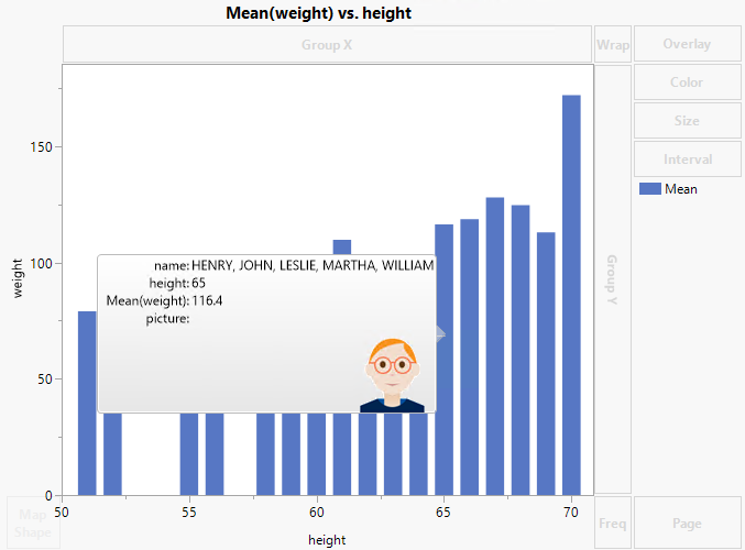

6. Hover over the bar for the height of 65 inches and click the Pin element Image shown here.
Figure 9.67 Hover Label with Only Initial Image
Although five names are included in this bar, only the first image appears in the hover label. You want to see more images in the hover label.
7. Right-click in the graph and select Hover Label > Label Viewer.
Figure 9.68 Hover Label with Multiple Images
The maximum of eight images now appear in the hover label.
8. To see the additional image, click a thumbnail in the hover label.
9. In the Label Viewer, click the Forward arrow Image shown here to see the fifth image.
