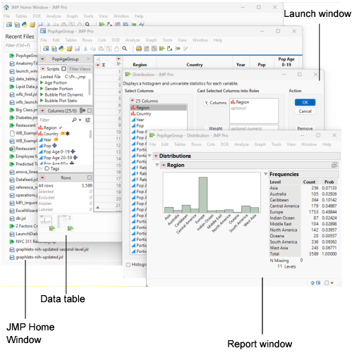

JMP consists of platforms that are organized by the type of statistical analysis. For example, the Distribution platform produces a univariate analysis by using histograms, additional graphs, and reports. You might analyze data in the Distribution platform and then choose another platform to examine the data more thoroughly. As a result, several windows are open at once: at a minimum, the data table, platform launch windows, and the results of the analyses.
Figure 2.2 shows a typical JMP session. Note that the windows are not maximized so that you can quickly switch from one window to another.
Figure 2.2 Anatomy of a Typical JMP Session on Windows
The following sections describe the windows that you typically work with.
