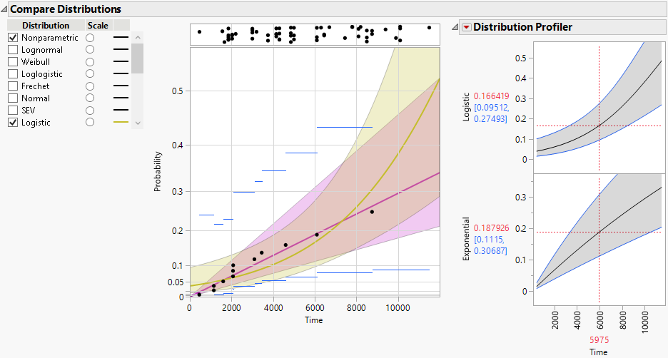

For each distribution that you select, the Compare Distributions report is updated to show the following elements:
• The estimated cumulative distribution curve, which appears on the probability plot
• A shaded region that indicates confidence intervals for the cumulative distribution
• A Distribution Profiler that shows the cumulative probability of failure for a given period of time
Figure 3.9 shows an example of the Compare Distributions report. The Logistic (yellow) and Exponential (magenta) distributions are shown. The plot is scaled using the Exponential distribution.
Figure 3.9 Compare Distributions Report and Distribution Profiler
