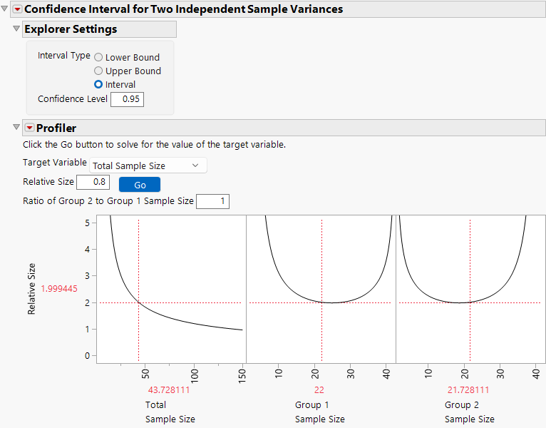

In this example, use the Confidence Interval for Two Independent Variances Explorer to calculate the sample size that is needed to estimate the ratio of two group variances with a relative size of 2 with 95% confidence. The calculated sample size enables you to estimate a confidence interval for the ratio of the variances that is twice as wide as the ratio of the variances.
1. Select DOE > Sample Size Explorers > Confidence Intervals > Confidence Interval for Two Independent Sample Variances.
2. Leave Interval Type set to Interval for estimating a sample size for a two-sided confidence interval.
3. Leave Confidence Level set to 0.95.
4. Leave Target Variable set to Total Sample Size.
5. Set Relative Size to 2.
6. Leave Ratio of Group 1 to Group 2 Smaple Size to 1 for equal group sizes.
7. Click Go.
Figure 29.10 Two Independent Sample Variance Explorer
You need to collect 22 samples in each group to estimate a two-sided confidence interval for the ratio of the sample variances of width twice the ratio of the variances.
