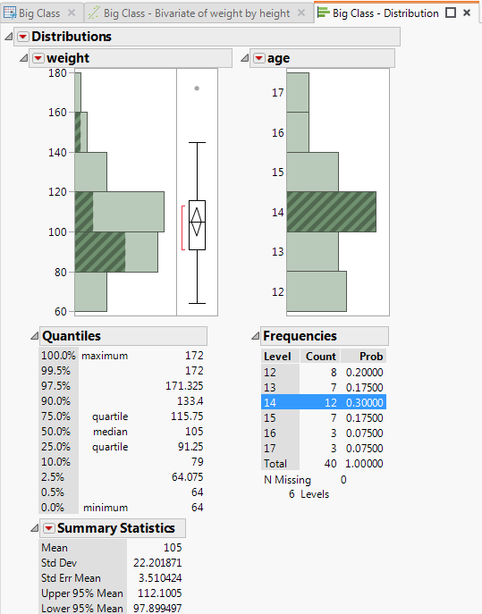

Figure 16.1 shows the project with selected bars, showing that the graph is still linked to the data table.
Figure 16.1 Example of a Simple Project
