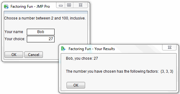

Prime Numbers.jsl asks the user to enter a number and then factors the number or confirms it as a prime number (Figure 19.5). This script is a good example of aligning several types of display boxes, concatenating text, and working with conditional functions.

Figure 19.5 Factor Numbers Interactively
