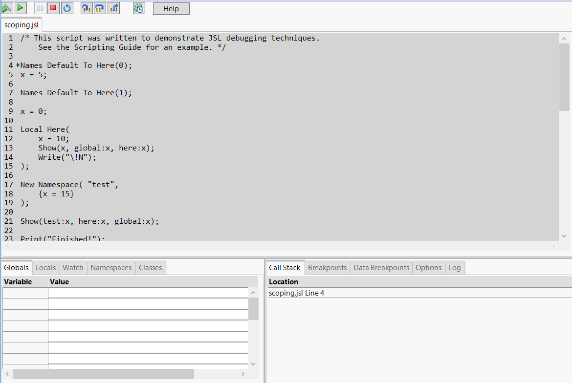

The Debugger opens in a new instance of JMP (Figure 4.11). The original instance is inoperable until the script produces something that requires interaction. At that point, the Debugger window becomes inoperable until you perform whatever action is required. Then control is returned to the Debugger. Close the Debugger to work again in the original instance of JMP.
Figure 4.11 The Debugger Window
The Debugger Window
Use the buttons at the top to control the Debugger or the JSL Profiler. One or more scripts that you are debugging or profiling are shown in tabs. If your script includes other scripts, each one opens in a new tab.
Tabs in the bottom portion of the Debugger provide options to view variables, namespaces, the log, and the current execution point; work with breakpoints; and set options.
Tip: To view or edit long values on a tab in the Debugger, right-click the value and select Edit. The code opens in a script editor.
