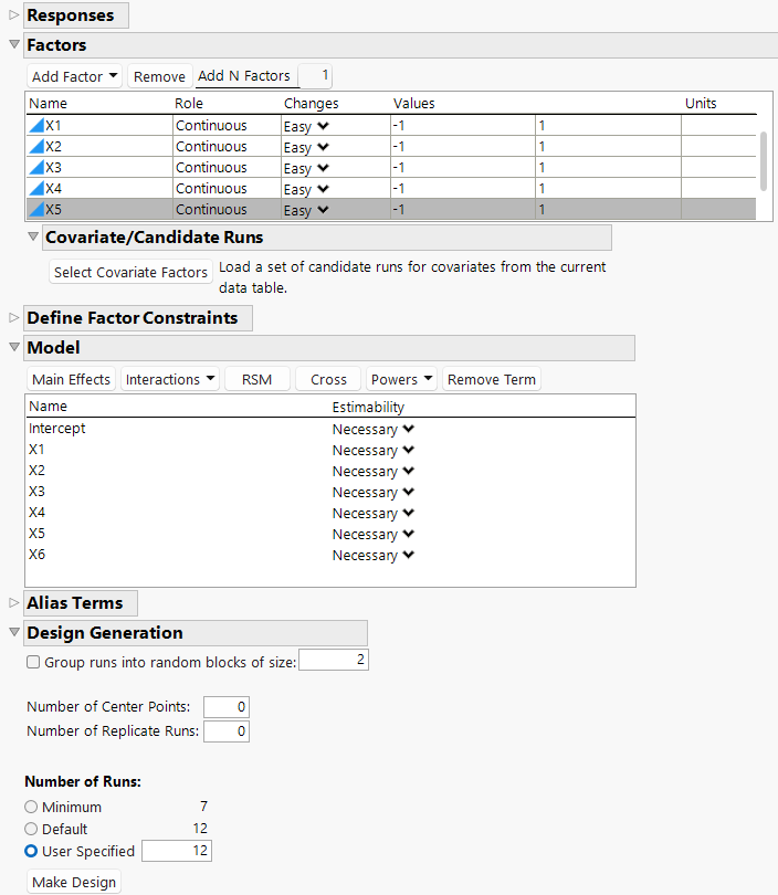

1. Select DOE > Custom Design.
2. In the Factors section, type 6 next to Add N Factors.
3. Click Add Factor > Continuous.
4. Click Continue.
The Model section appears. It includes only main effects with Estimability designated as Necessary. This means that all main effects are estimable in the design that is generated.
Figure 5.2 Custom Design Window That Shows the Model Section
Keep the default of 12 runs.
