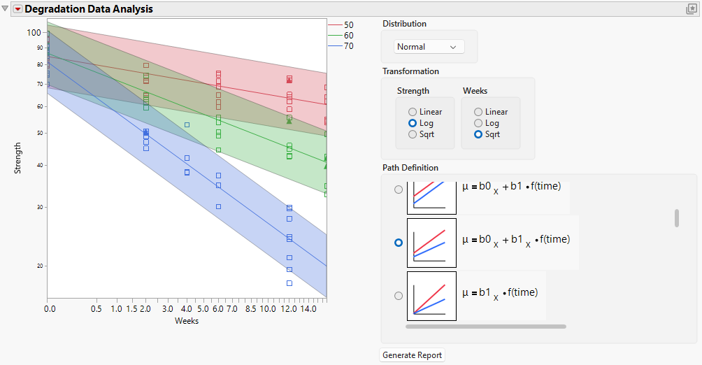

Figure 10.1 Destructive Degradation Example of Model for Adhesive Bond.jmp
