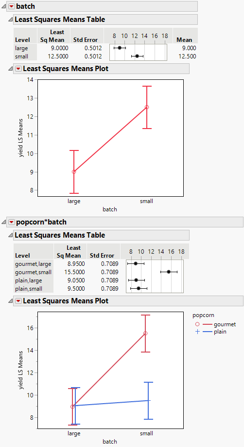

LSMeans Table
Least squares means are values that are predicted by the model for the levels of a categorical effect where the other model factors are set to neutral values. The neutral value for a continuous effect is defined to be its sample mean. The neutral value for a nominal effect that is not involved in the effect of interest is the average of the coefficients for that effect. The neutral value for an uninvolved ordinal effect is defined to be the first level of the effect in the value ordering.
Least squares means are also called adjusted means or population marginal means. Least squares means can differ from simple means when there are other effects in the model. In fact, it is common for the least squares means to be closer together than the sample means. This situation occurs because of the nature of the neutral values where these predictions are made.
Because least squares means are predictions at specific values of the other model factors, you can compare them. When effects are tested, comparisons are made using the least squares means. For more information about least squares means, see “Least Squares Means across Nominal Factors” and “Ordinal Least Squares Means”.

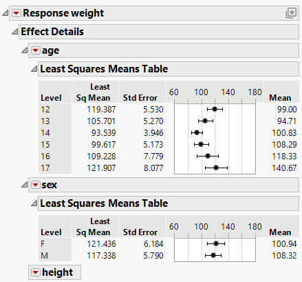

The Effect Details report, shown in Figure 3.10, contains reports for each of the three effects. Least Squares Means tables are given for age and sex, but not for the continuous effect height. Notice how the least squares means differ from the sample means.
Figure 3.10 Least Squares Mean Table
The Least Squares Means report contains the following columns:
Level
The categorical levels or combination of levels.
Least Sq Mean
An estimate of the least squares mean for each level.
Estimability
(Appears only when a least squares mean is not estimable.) A warning if a least squares mean is not estimable.
Std Error
The standard error of the least squares mean for each level.
Lower 95%
The lower 95% confidence limit for the least squares mean. This column appears only if you have the Regression Reports > Show All Confidence Intervals option selected or if you right-click in the report and select Columns > Lower 95%.
Upper 95%
The upper 95% confidence limit for the least squares mean. This column appears only if you have the Regression Reports > Show All Confidence Intervals option selected or if you right-click in the report and select Columns > Upper 95%.
CI
A plot of the magnitude of each difference with a confidence interval.
Mean
(Appears only for main effects.) The response sample mean for the given level. This mean differs from the least squares mean if the values for other effects in the model do not balance out across this effect.
LSMeans Plot
The LSMeans Plot option produces a Least Squares Means Plot for nominal and ordinal main effects and their interactions. If the effect is an interaction, this option displays the Least Squares Means Plot Options window. See Least Squares Means Plot Options.
The Least Squares Means Plot red triangle menu contains the following options:
Show Confidence Limits
Shows or hides confidence limits for each estimate in the plot.
Show Connected Points
Shows or hides one or more lines that connect the least squares means for each level in the plot.
When you select the LSMeans Plot option from the red triangle menu of an interaction effect, the Least Squares Means Plot Options window appears.
Figure 3.11 Least Squares Means Plot Options Window
If you click OK without selecting anything in the window, one LSMeans Plot appears. The horizontal axis of the plot consists of the levels of the factors nested to obtain a separate effect for each combination. To create an interaction plot, select the box next to Create an Interaction Plot. The Choose Terms for Overlay option enables you to select which effect is displayed as the overlay variable in the interaction plot.
For a three-way interaction term, a second panel of options appears after you choose an overlay variable for the interaction plot. If you click OK without selecting anything in the second panel, one interaction plot appears. Alternatively, use the second panel of options to create separate interaction plots for each level of the effect that you select under Choose Terms for Separate Plots. See “Example of an LS Means Plot”.
Figure 3.12 Least Squares Means Tables and Plots for Two Effects

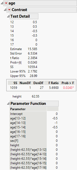

LSMeans Contrast
A contrast is a linear combination of parameter values. In the Contrast Specification window, you can specify multiple contrasts and jointly test whether they are zero.
JMP builds contrasts in terms of the least squares means of the effect. Each column of the contrast is normalized to have sum zero and so that the sum of the absolute values equals two. If a contrast involves a covariate, you can specify the value of the covariate at which to test the contrast.
The Contrast Specification box shows the name of the effect and the names of the levels in the effect. The contrast values are initially set to zero and appear next to cells containing + and - signs. Click these buttons to compare levels.
Each time you click the + or - button, the contrast coefficients are normalized to make their sum zero and their absolute sum equal to two, if possible. To compare additional levels, click the New Column button. A new column appears in which you define a new contrast. After you are finished, click Done. The Contrast report appears (Figure 3.13). The overall test is a joint F test for all contrasts. See “Example of an LSMeans Contrast”.
Note: If you attempt to specify more than the maximum number of contrasts possible, the test automatically evaluates.
The Contrast report provides the following details about the joint F test:
SS
The sum of squares for the joint test.
NumDF
The numerator degrees of freedom.
DenDF
The denominator degrees of freedom.
F Ratio
The ratio of SS divided by NumDF divided by the mean square error.
Prob > F
The p-value for the significance test.
Test Detail Report
The Test Detail report (Figure 3.13) shows a column for each contrast that you tested. For each contrast, the report gives its estimated value, its standard error, a t ratio for a test of that single contrast, the corresponding p-value, its sum of squares, and a confidence interval for the contrast estimate. The default significance level for the confidence interval is 0.05, but you can specify a different significance level in the Fit Model launch window.
Parameter Function Report
The Parameter Function report (Figure 3.13) shows the contrasts that you specified expressed as linear combinations of the terms of the model.
Figure 3.13 LSMeans Contrast Report

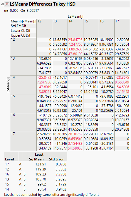

LSMeans Student’s t and LSMeans Tukey HSD
The LSMeans Student’s t and LSMeans Tukey HSD (honestly significant difference) options test pairwise comparisons of model effects.
The LSMeans Student’s t option is based on the usual independent samples, equal variance t test. Each comparison is based on the specified significance level. The overall error rate resulting from conducting multiple comparisons exceeds that specified significance level.
The LSMeans Tukey HSD option conducts Tukey HSD tests. For these comparisons, the significance level applies to the entire collection of pairwise comparisons. For this reason, confidence intervals for LS Means Tukey HSD are wider than those for LSMeans Student’s t. The significance level is exact if the sample sizes are equal and conservative if the sample sizes differ (Hayter 1984).
Figure 3.14 shows the LSMeans Tukey report for the effect age in the Big Class.jmp sample data table. (To obtain this report, run the Fit Model data table script, click the age red triangle, and select LS Means Tukey HSD.) By default, the report shows the Crosstab Report and the Connecting Letters Report.
Figure 3.14 LSMeans Tukey HSD Report
The Crosstab Report
Both options display a matrix, called the Crosstab Report, where each cell contains the difference in means, the standard error of the difference, and lower and upper confidence limits. The significance level and corresponding critical value are given above the matrix. The default significance level is 0.05, but you can specify a different significance level in the Fit Model launch window. Cells that correspond to pairs of means that differ statistically are shown in red.
The Connecting Letters Report
A Connecting Letters Report appears by default beneath the Crosstab matrix. Levels that share, or are connected by, the same letter do not differ statistically. Levels that are not connected by a common letter do differ statistically.
In Figure 3.14, levels 17, 12, 16, 13, and 15 are connected by the letter A. The connection indicates that these levels do not differ at the 0.05 significance level. Also, levels 16, 13, 15, and 14 are connected by the letter B, indicating that they do not differ statistically. However, ages 17 and 14, and ages 12 and 14, are not connected by a common letter, indicating that these two pairs of levels are statistically different.
Tip: Right-click in the connecting letters report and select Columns to add columns containing connecting letters (Letters), standard errors (Std Error), and confidence interval limits (Lower X% and Upper X%). In the Letters column, the connecting letters are concatenated into a single column. The significance and confidence levels are determined by the significance level that you specify in the Fit Model launch window using the Set Alpha Option.

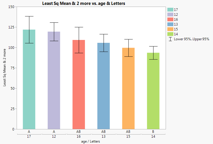

Save Connecting Letters Table
Creates a data table with columns that contain the levels of the effect, the connecting letters, the least squares means, their standard errors, and confidence intervals. The table contains a script called Bar Chart that produces a colored bar chart of the least squares means with their confidence intervals superimposed on the chart. The levels are arranged in decreasing order of least squares means.
Figure 3.15 Bar Chart from LSMeans Differences HSD Connecting Letters Table

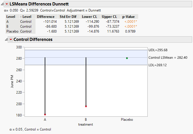

LSMeans Dunnett
Dunnett’s test (Dunnett 1955) compares a set of means against the mean of a control group. The error rate applies to the collection of pairwise comparisons. The LSMeans Dunnett option conducts Dunnett’s test for the levels of the given effect. Hsu’s factor analytical approximation is used for the calculation of p-values and confidence intervals (Hsu 1992).
When you select LSMeans Dunnett, you are prompted to enter a control level for the effect. The LS Means Differences Hsu-Dunnett report shows the significance level, the value of the test statistic (Q), and the control level.
A report for the LSMeans Dunnett option for effect treatment in the Cholesterol.jmp sample data table is shown in Figure 3.16. Here, the response is June PM and the level of treatment called Control is specified as the control level.
Figure 3.16 LSMeans Dunnett Report
The report contains the following two options:
Control Differences Report
Shows or hides a table that contains a row for each level of the effect other than the control. Each row contains the level being compared to the control level, the estimated difference, the standard error of the difference, a confidence interval, and the p-value for the comparison.
Control Differences Chart
Shows or hides a chart that contains a point for each level of the effect other than the control. Each point shows the least squares mean for that level in relation to the least squares mean for the control level. Upper decision limits (UDL) and lower decision limits (LDL) are plotted.
The Control Differences Chart report menu contains the following options:
Show Summary Report
Shows or hides a table that contains the estimate, decision limits, and the limit exceeded for each group.
Display Options
Contains several options for controlling the display of the chart.
